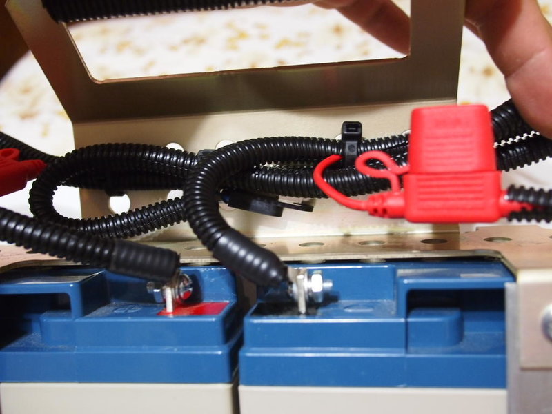

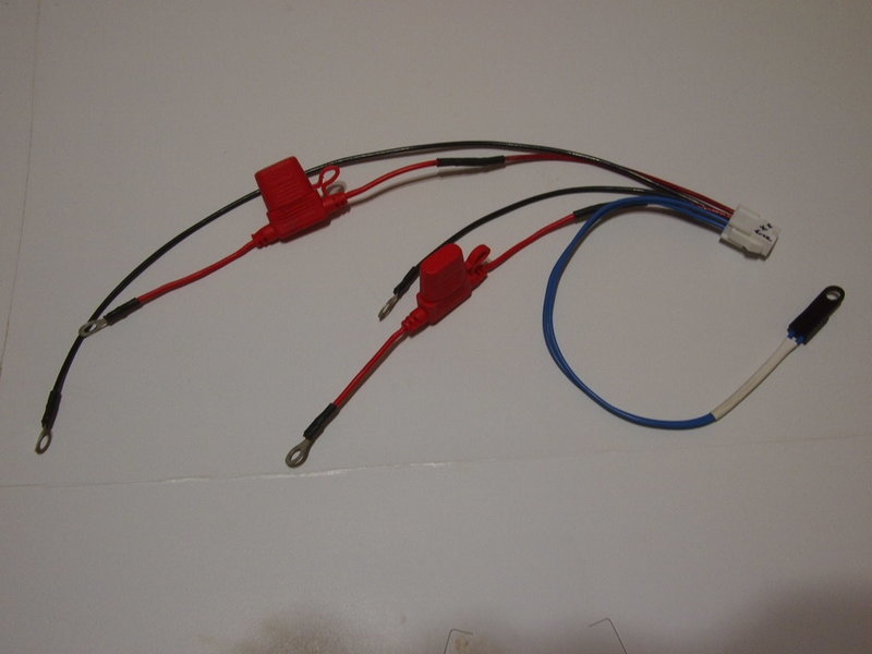

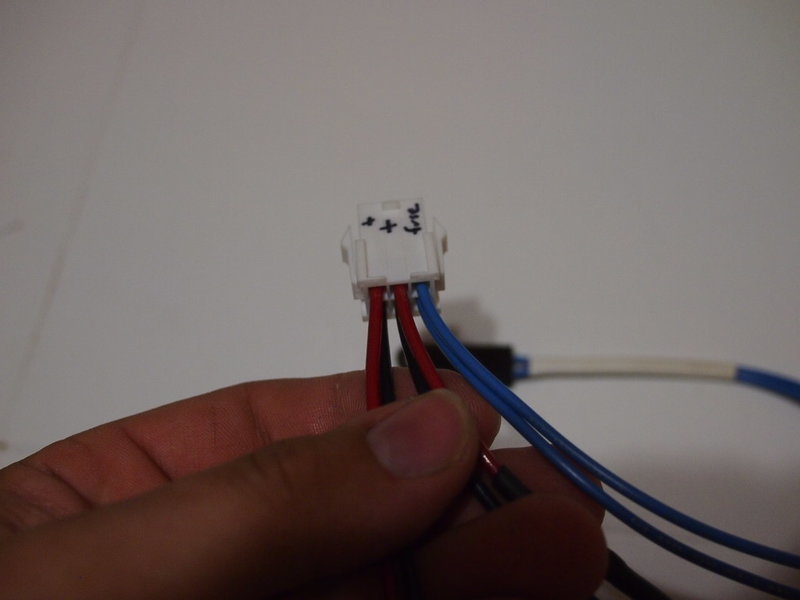

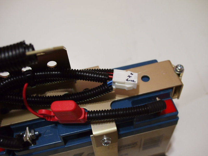

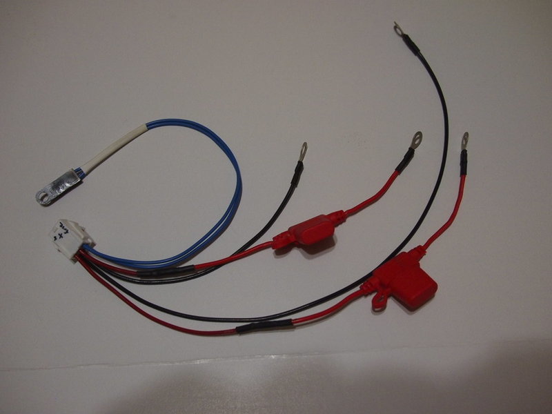

    Updates! Here's pics of the harness I've created.
    _EP38868.jpg _EP38872.jpg _EP38873.jpg _EP38874.jpg _EP38877.jpg _EP38878.jpg _EP38879.jpg
    Initial testing is going well. I plugged in the unit with AC power and the batteries achieved full charge it about 1 hour. I then unplugged the fridge and let it run on "cool" mode til they were dead. It maintained 4*C for 33 hours. Room temperature varied between mid 80s to mid 70s, maybe mid 60s at night. I then plugged in AC power and the batteries recharged completely in about 9 hours while still maintaining 4*C.
    I'm currently testing "freeze" mode on AC power. Once it reaches temp I will unplug it and see if it runs properly on battery power. It draws a bit more current on freeze setting, I believe. After that I want to try testing it on DC. I'm thinking of hooking it up to a jump box and seeing if the fridge will run and charge the batteries on DC power.
    A question about fuses. I have a 5A fuse in each battery positive. The unit is supposed to draw around 4.5A max. Should I replace each fuse with a 3A so I have 6A total? If I have 10A total as it sits could that be too much margin?

    yea, I had to make a $500 minimum order. I built my own harness with stuff I had around for like $17!
    *EDIT* And lots of help from the community!

    Given the way those batteries are wired, it looks like either one can run the whole thing, so I think you need 5A on each.
