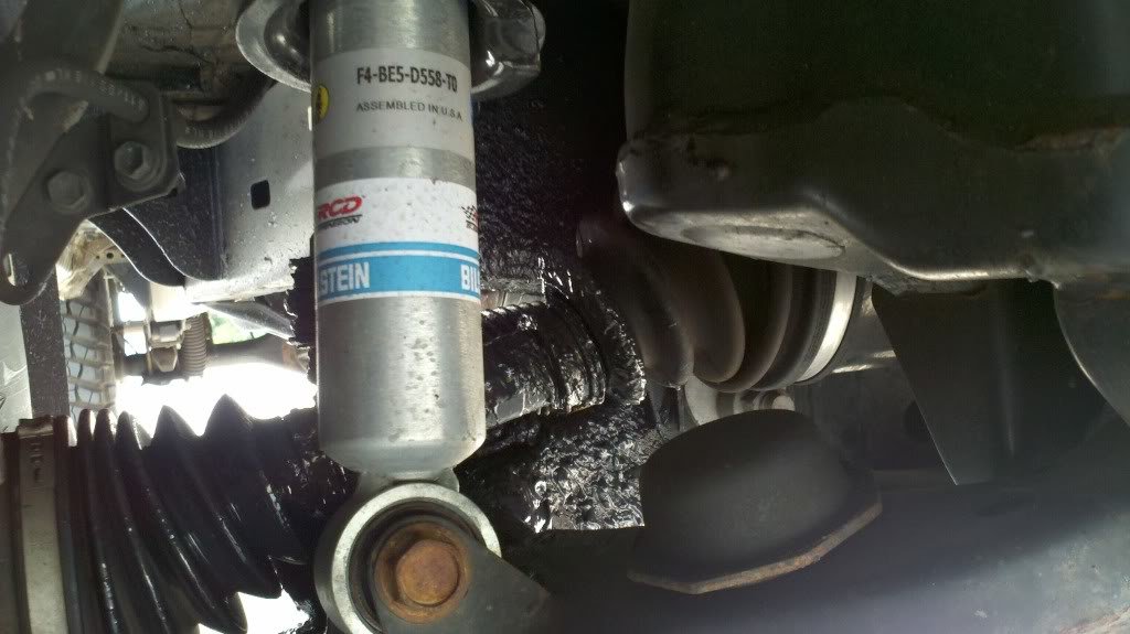

    I'd still lower the front though, I'm running 3" and I've blown both boots. Didn't think my angle was "that bad" either.

    this was me, at 3.5" of lift.

    That looks exactly like mine were... Had to install aftermarket CV's. I think the boot slipped off of the 'washer' thing that held the boots on the shaft. Wasn't too bad to replace both of them. 1st one took 45acp and I 3 hours, second one only took 31 minutes :D
