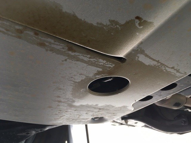

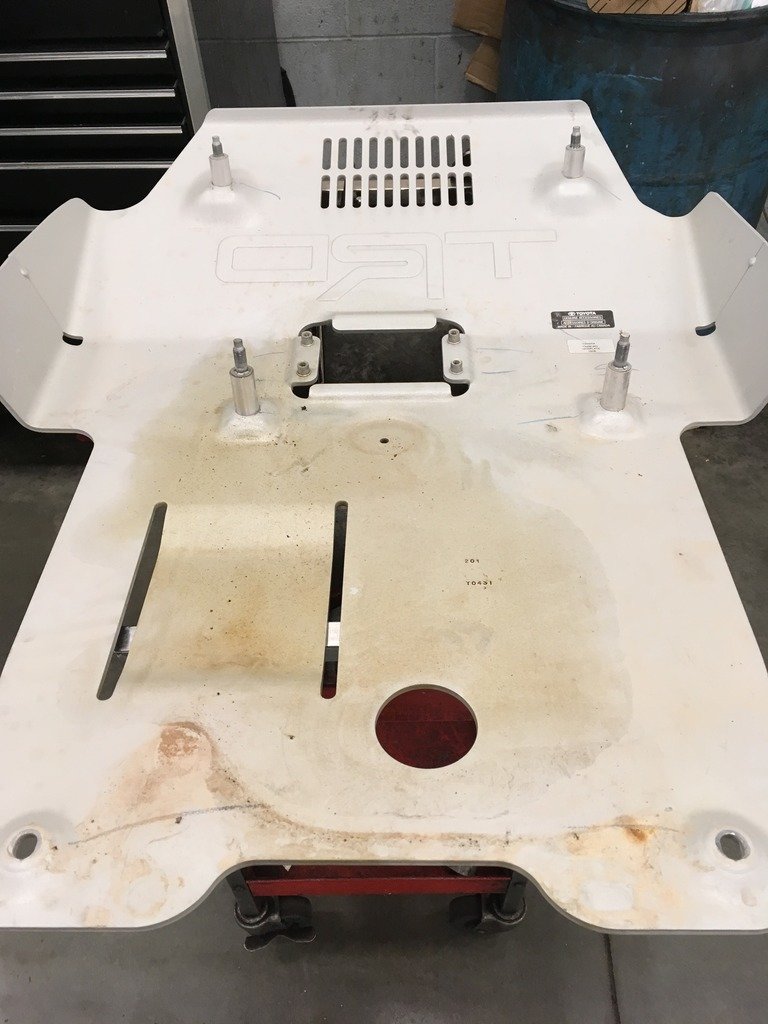

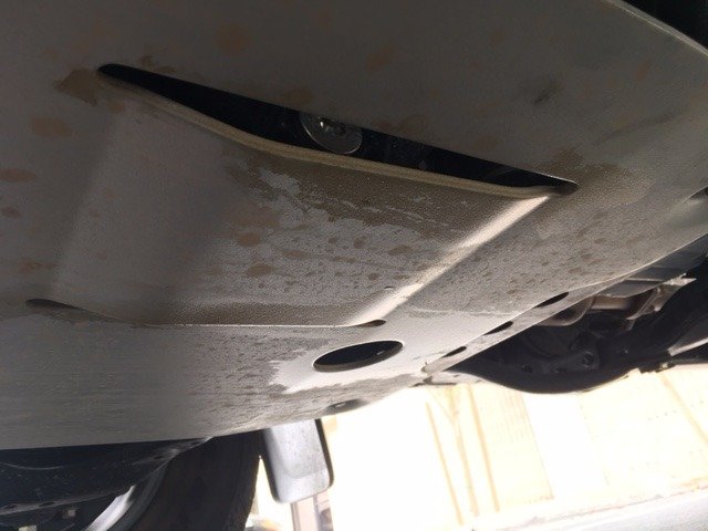

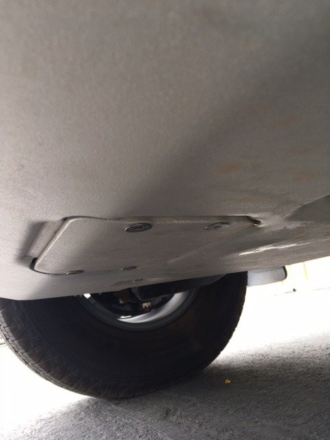

    THE SAGA CONTINUES - THE OIL CHANGE THAT NEVER ENDS! PART 2:
    Upon further investigation, it turns out they had the skid plate access panel installed backwards. The curved edge should face forward towards the front of the truck.
    Oh, and now I get to deal with this...
    Awesome!

    Service manager put my truck on a lift to inspect oil seepage with me present. Dropped the skid plate to find a nice pool of residual oil from what appeared to be the main drain plug. Dropped cartridge filter to find that it had been replaced during the oil change. Whew! Installed new cartridge and o-ring for peace of mind. Had to request for mechanic to use torque wrench on skid plate bolts as he openly admitted that most guys only use impact wrench. Doh! (33ft-lbs,21ft-lbs main skid bolts, 18ft-lbs access panel) Every bolt needed extra tightening.
