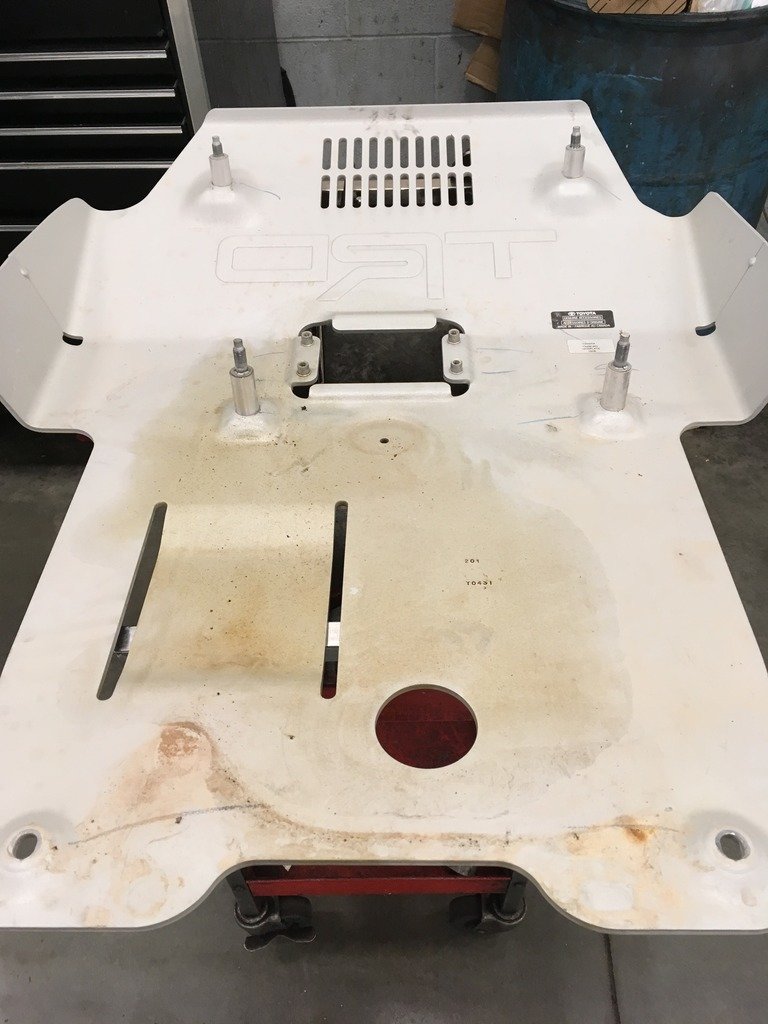

    A few possibilities, right?
    1. O-ring was missing.
    2. Old O-ring was used.
    3. New O-ring was used, but got damaged when the housing cap was reinstalled (can happen because O-ring is thin and the cap is large diameter).

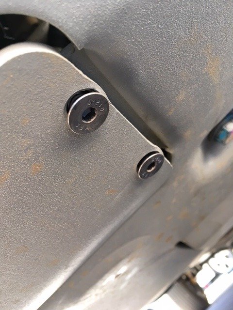

    Hey,
    Does anyone know the bolt size for that small panel access. Dealership is asking me over $80. They say it comes as a kit and they don't sell those bolts by itself. He didn't know the part number or the size.
    Baxter Toyota of La Vista. In Omaha, NE

    Here- searched it up:
    “The filter cover screws are M8-1.25 x 25mm, 5 mm drive flat hex socket head, 4.4mm head height, 16mm head diameter,grade12.9, zinc plated, fully threaded, standard profile (90 degree)...”
    https://www.tacomaworld.com/threads/stock-skid-plate-bolt-size.572942/#post-23510007
