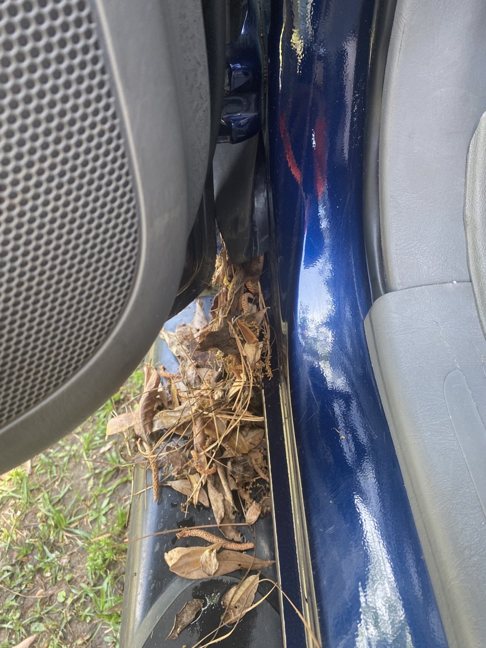

    This spot. For all those hat haven’t removed the plastic wheel well walls- peel back the seal on your forward door jambs and get all that crap out.. I upgraded to this truck in October, and I don’t believe the previous owner ever did this. Picture included was maybe half of all the stuff collected in there... That’s virtually rust in the making. Luckily is was still dry.. somehow.
    What are some other often-overlooked places to clean on your Tacoma? Nooks and crannies that are missed on the casual wash?

    So much crap collects in that spot. I clean mine out a couple times a year and have had to do a little rust repair.

    Great post, Hyper. Didn't even know about that panel.

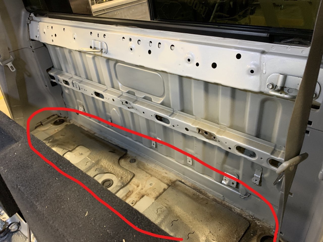

    Fender liners are always good to check if you've been parked under trees long term. This may be an extreme example but it doesn't hurt to do this at least once if you bought your truck used. Especially if you have any odd odors, I pulled all the old carpet out replaced it with rubber flooring and deep cleaned the floor pans. Amazing how much mud, loose change, and crusty coffee the previous owner got under the carpets.
    Little example of what the entire floor pan looked like before cleaning.

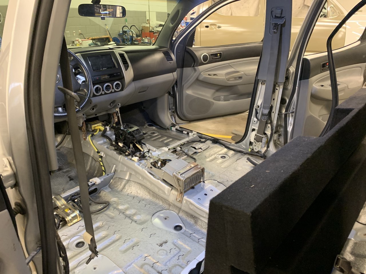

    Cleaned up nice with very little rust.

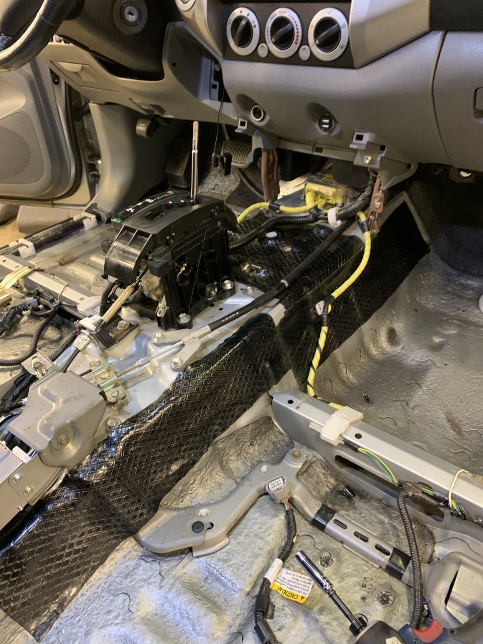

    You'd be surprised how nasty it is under the center console.

    Dang.. Sure that wasnt a rodent nest? Ive poked in there a few times to spray Fluid Film and dont think Ive ever found more than a few leaves here and there.

    I can't quite figure out what I'm looking at here. Where is this stuff collecting?

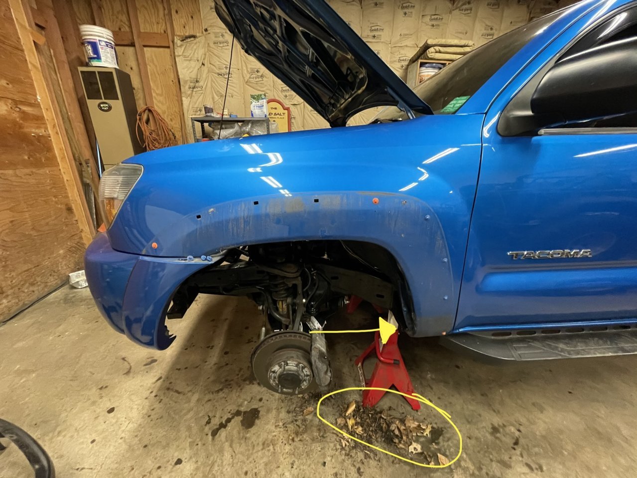

    Found an alarming amount of composting leaves behind the front inner fender liner on both sides.

    Oh that puts it into perspective much better. Thanks, I'll have to check mine.

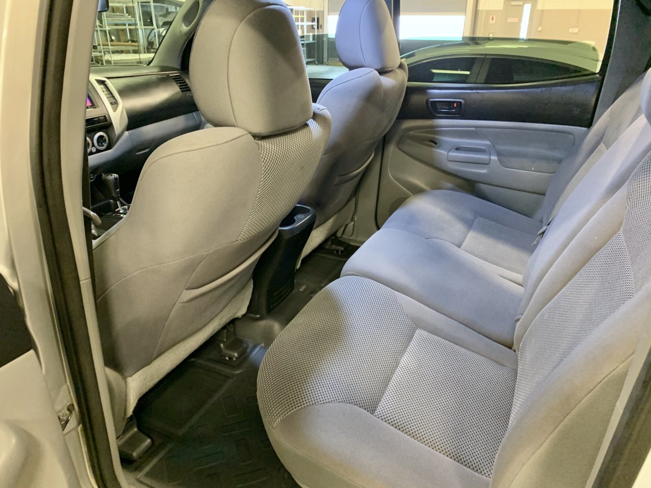

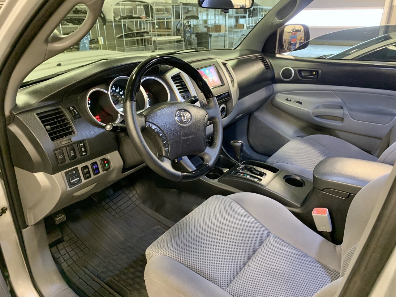

    Got any pictures, or links to the rubber flooring you used?

    Yes I get junk accumulation there too, more than any other place (that I know of) on my truck.

    Oh yeah man- thanks for that clarity. Good pic!

    These are the only pics I have of my rubber flooring at the moment. I can take more pics later. It's actually an OEM Toyota part. I don't know which model year Tacomas were shipped with the option for rubber floors but I would take it everyday over carpet.

    I did this when I first bought my truck, definitely have to do it again. It sounds like there's an acorn or something rolling around in there too.

    do you access the liner flap from the angle of the photo, looking forward?
    or do you mean looking rear, at back of wheel well area? i need to do this for sure
