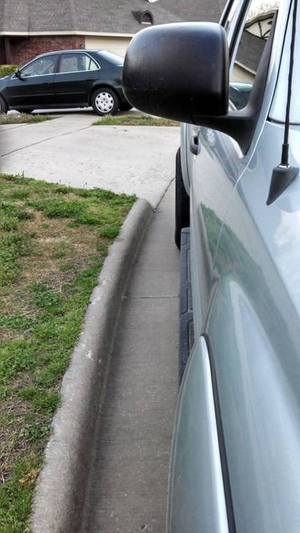

    Do you have any pics straight down the side? It looks like they are pushed out from the fender. I'm trying to tell how much they stick out.

    Thanks. I think I've made my mind up! Appreciate the help!
