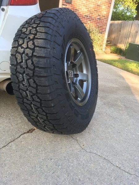

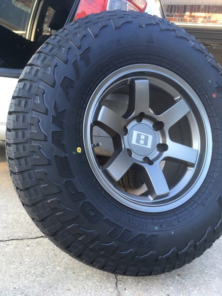

    0 offset should be perfect fit - but -10 would stick 1/2" further out which normally looks a little better and should be more flush with fender. But also more chance to rub from my past experience. I am looking at same wheel but with falken wildpeak tire.
    Here is one i ordered in -10 with 265/75/16

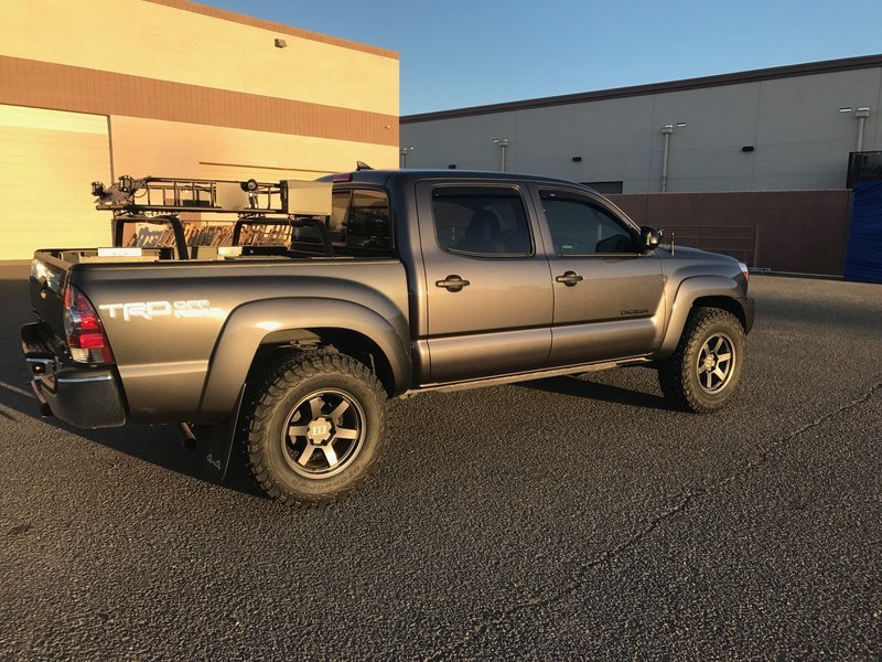

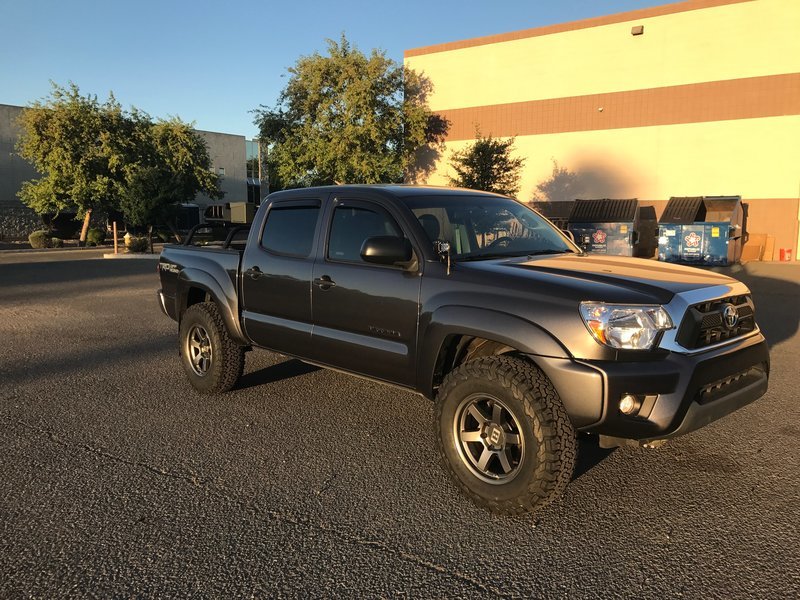

    Couldn't be happier with mine.
    Just need to get creative with the center cap.

    Bilstein 5100's all round and set at 0.85" up front. Tires are KO2 275/70/70 on 17x9 with what I believe is a -12 offset. I had some fender rub to begin with then once I cleared that issue noticed I was still rubbing against my cab mounts so they will be getting chopped some evening this week when I find time. They only rub if I am braking, turning and hit a bump or pull into the driveway. Other than that its fine but I want maximum clearance so I don't get any unnecessary wear on the new tires.

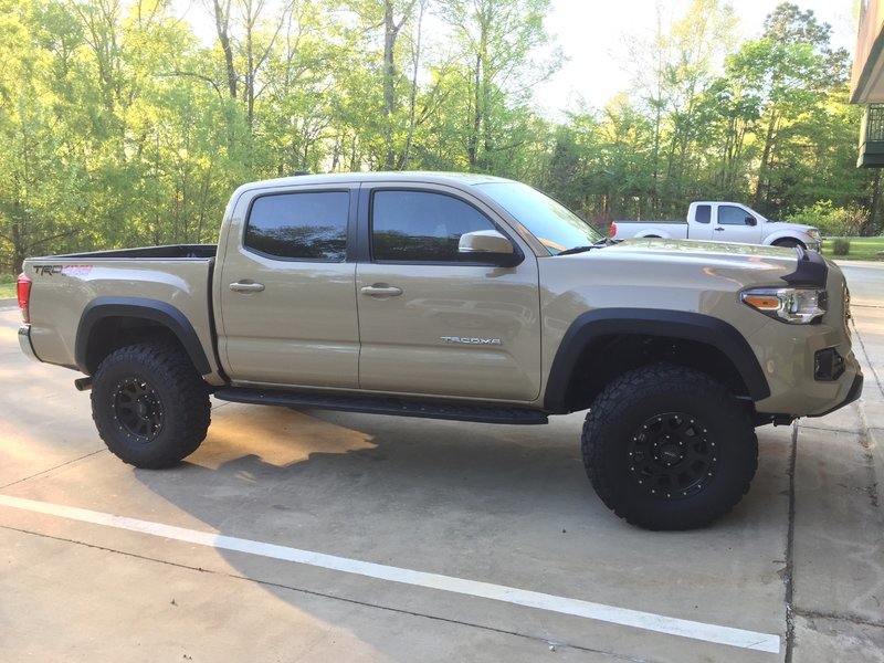

    Bilstien coilovers Toytec AAL w/fox 2.0's Sway bar relocate Carrier bearing drop ECGS needle bearing delete 285/75/16 Dick Cepek Extreme Country
    Looking to put the 16x8 bronze on my 2017 lifted 3 inches with 286/75/16.
    Ditching these steel MB wheels that came with the tires on a trade.
    Stance 'look' set aside, is the 0 or -10 going o be the best fit? I don't want any issues with rub. @Discount Tire Direct
