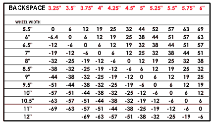

    these are sweet...quick question,I am going to run 265/70-17. what offset would be better?17x8 0 offset or 17x8 -10 offset? will the -10 offset be pushed out a additional .394 inch= wider stance?

    The -10mm offset option should be a great fit with your lift and flares.
    Yes the -10 will stick out about .4" further than the 0mm offset. Either one will work.

    A 17x8 wheel with a -10 offset = between a 4" and 4.25" backspace.
    A 17x8 wheel with a 0 offset = 4.5 backspace.
    I thought that the lower the backspace the more tucked into the fender well the wheel would be? Im just trying to understand. Wouldnt the 0 offset stick out further?

    Lower offset/backspace wheels typically push out away from the suspension and towards the fenders. Check out the write-up we put together on this subject.
    Offset & Backspace - How Do They Relate
