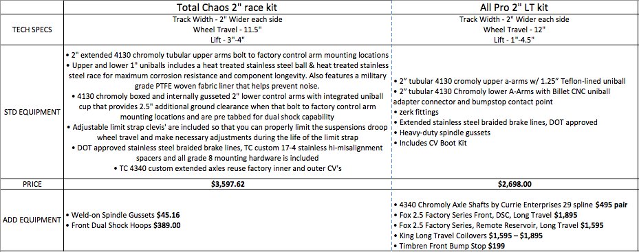

    After doing research on a 2" LT kit that I can still use on and off road, here are the companies I have looked at and here are the pros and cons of all, please jump in with your photos and comments on the kit you are running and your experience with the kit!

    TC vs Solo Motorsports
    https://www.tacomaworld.com/threads...torsports-front-lt-kits.481369/#post-15396649
    Companies Considering: Total Chaos (TC), @allpro , Solo Motorsports, and Baja Kits

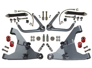

    Total Chaos 2" LT Race Kit:

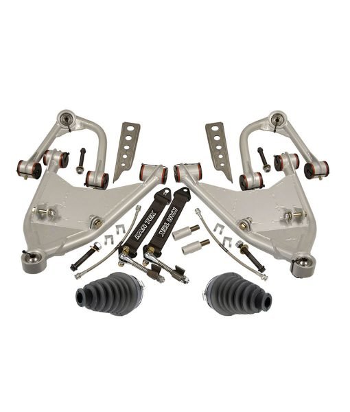

    All Pro 2" LT Kit

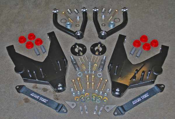

    Baja Kits 2" LT Kit

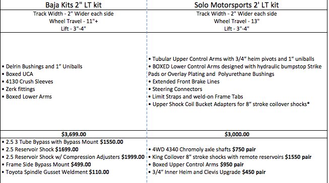

    Solo Motorsports 2" LT Kit
    Pros:
    ALL PRO AND SOLO MOTORSPORTS USE KAR TEK LIMITING STRAPS
    SOLO MOTORSPORTS HAS AN OUTSIDE MOUNTED BUMPSTOP PLATE TO LIMIT UP TRAVEL (IMO SEEMS THIS IS MORE FOR DESERT JUMPING)
    TC AND BAJA KITS HAVE DUAL FRONT SHOCK MOUNTING OPTIONS
    - DOES THIS LIMIT TRAVEL? SUPPOSEDLY IT PROVIDES BETTER RIDE QUALITY
    SOLO MOTORSPORTS OFFERS MOST TRAVEL OF 13"
    ONLY BAJA KITS HAS BOXED UCA'S STND AND SOLO MOTORSPORTS OFFERS THEM OPTIONAL
    ALL PRO HAS PARTNERED W/CURRIE TO PROVIDE SPECIFIC EXTENDED AXLES
    ALL PRO AND BAJA KITS USE ZERK FITTINGS
    BAJA AND TC USE DELRIN BUSHINGS
    ALL PRO'S PRICE W/AXLE SHAFTS IS LOWEST OF THE KITS W/TOTAL OF $3,193 W/O SHOCKS
    TC COMES STANDARD WITH 3/4" INNER HEIM'S, SOLO MOTORSPORTS OFFERS THEM OPTIONAL
    CONS:
    ALL PRO HAS TUBULAR UPPER AND LOWER CONTROL ARMS (IDK IF THIS IS AN ACTUAL CON) - WHAT'S BETTER TUBULAR OR BOXED? IMO BOXED, STRONGER - COMMENT BELOW
