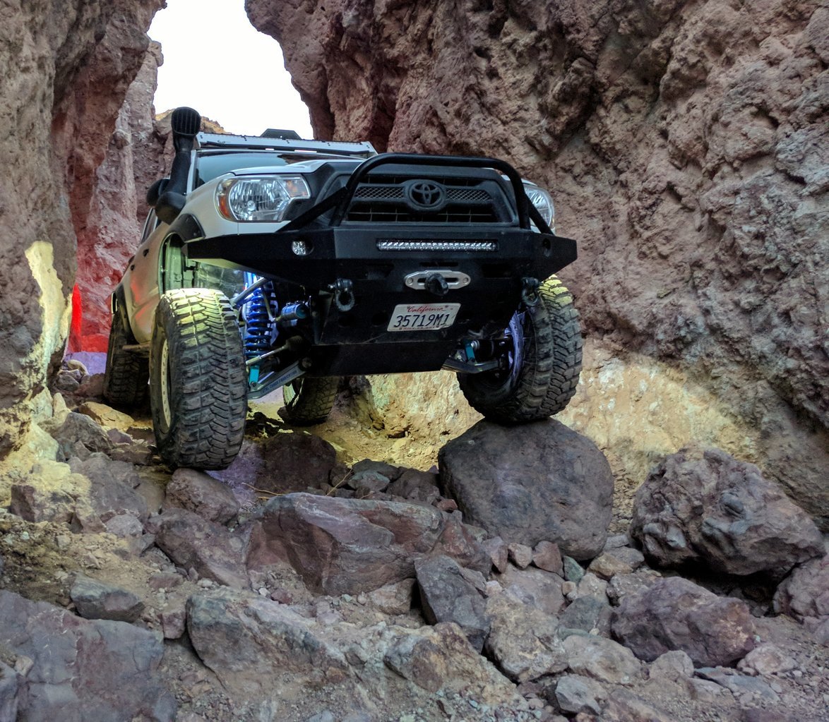

    You can fit a +2 without looking excessively illegal w/o fiberglass
    Don't want to deal with fiberglass install
    Don't trust fiber glass to hold up on the overgrown trails that I frequent
    Don't want to deal with the potential issues with my intents and wants with the bed and dealing with fiber glass bedsides
    While they are rare, some trails it would be too wide.
    20ft behind the truck is a section of canyon where i had full contact of the tire against the walls, a 3.5 straight up wouldn't fit
    Frequently drive on large rock strewn fucked up washes, it's easier for me to gauge distances to a large rock and avoid clipping it if my tires don't stick out that much
    To each their own, but to my eyes a +2 kit seems better for general purpose, a +3.5 treads into specializing in the open-track go fast-stuff

    What trail is that pic from? Your truck looks killer. Like an alien space craft with its landing lights on.
    Edit: Forgot to mention. I can definitely understand why someone would not want to go through the hassle of fiberglass. Its "three" extra items to do. purchase, fitment and paint.... Strength wise I've seen plenty of race trucks go through bushes with "race" glass, which is much thinner than what we would use (ive also seen them break it). But I have seen enough incidents where I dont personally sweat the strength of fiberglass.... Having said that my future fiberglass is surely going to crack in many many places.

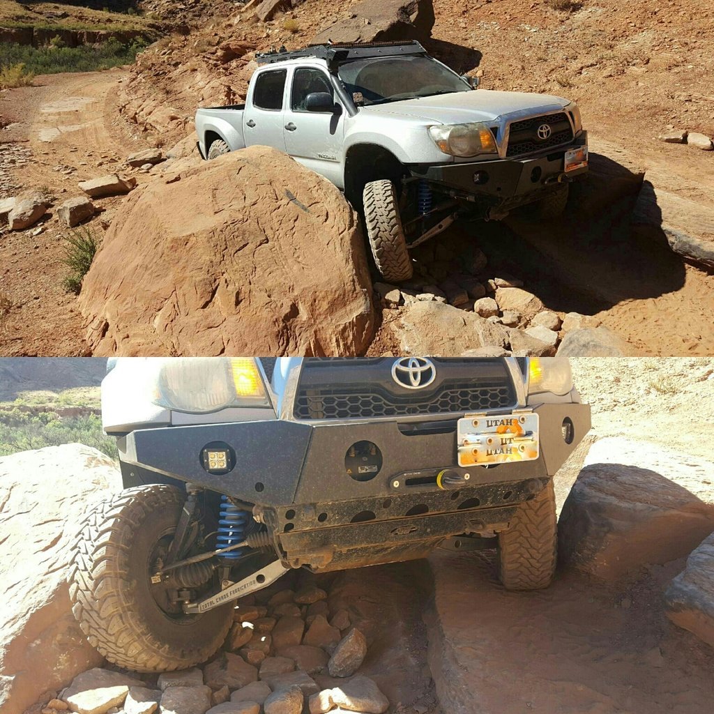

    I have only been on one trail where the +3.5 was too wide. Its Kane Creek down in moab. I don't have a front locker so I couldn't make it up a 3' ledge on the Left side. For the most part the extra width helps in a lot of situations. My front track width (outside tire to tire) is right at 84" with running 4.5" back spacing wheels and 255/85/16 tires.
    If your concerned about Glass and Paint, just get color matched Line-x. Its been holding up great. I have my front fenders, quarter panels, and bedsides covered in it.

    So what happened? Winch time?

    No, we turned around ( 30 point turn later LOL). It was just my wife and I on a thursday. Its a pretty remote trail. I didn't want to risk getting stuck at the end of the trail. Ill return one day and complete it!

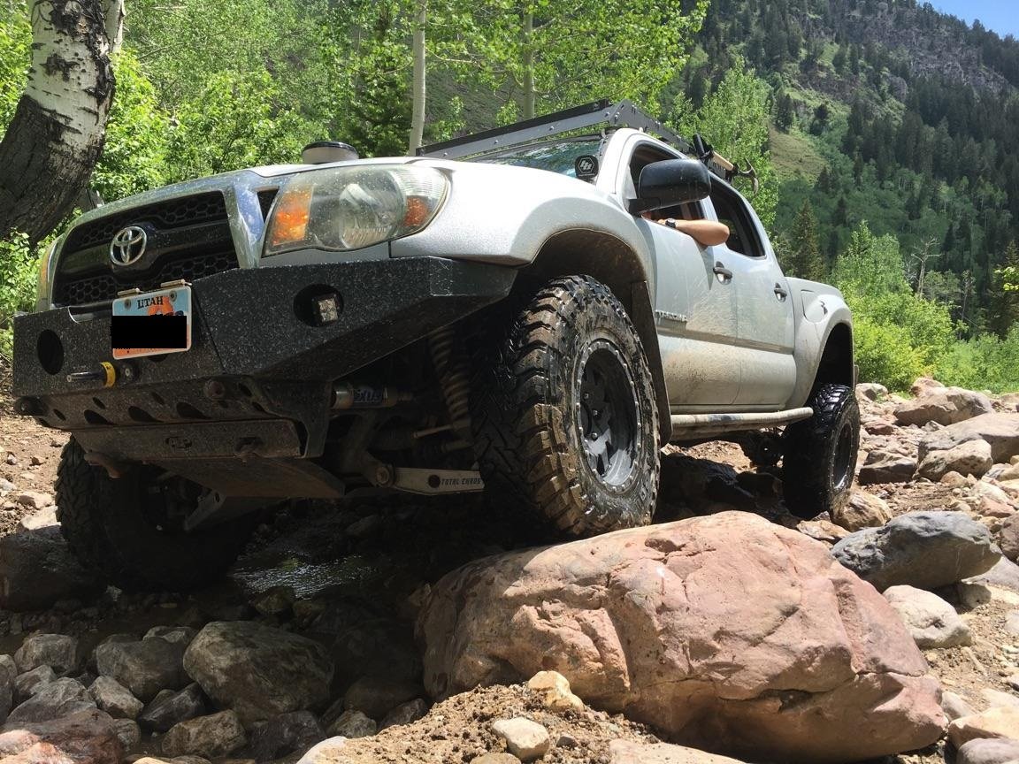

    This was my reasoning for going with the +3.5. My dad's jeep has 37"s on it and each tire is like 13" wide. His track width is basically right at the 84" that I have running a +3.5 kit. If the 3" difference between the +2 and the +3.5 is keeping me from running a trail, then I probably shouldn't be on that trail...
