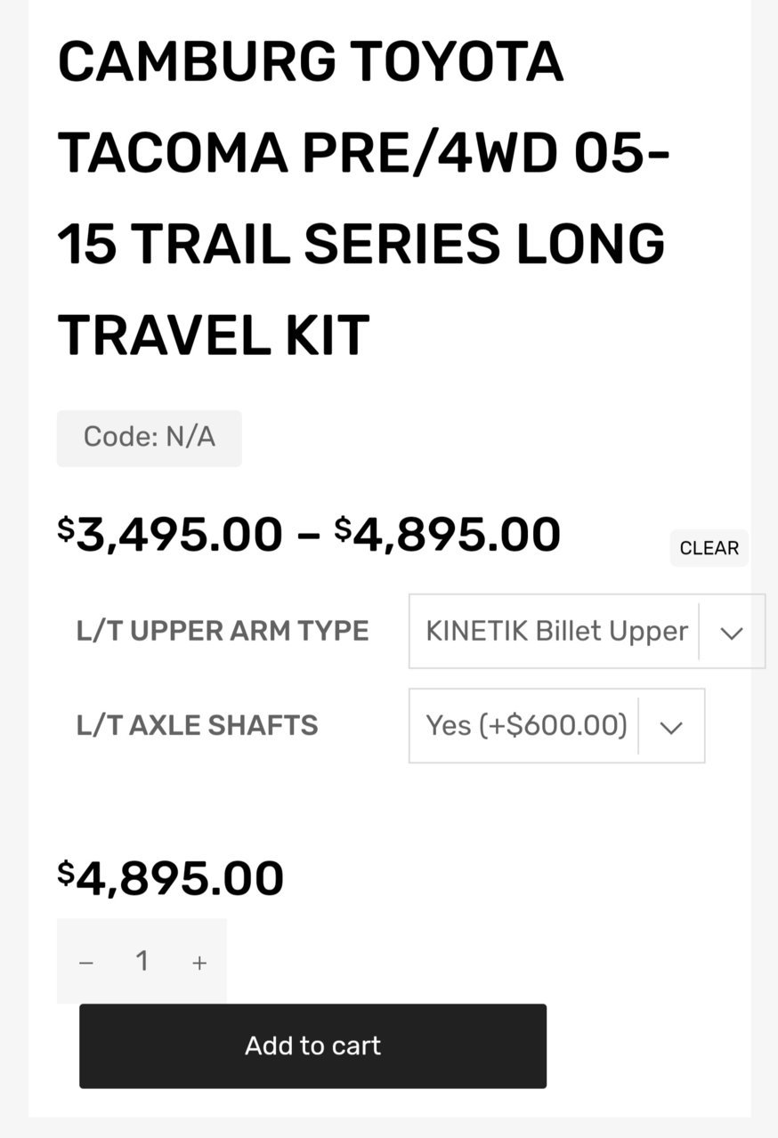

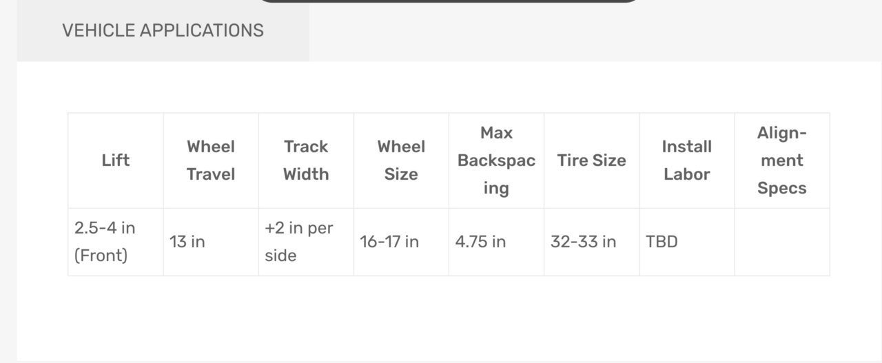

    Camburg has its own +2 inch coming out soon. I'm intrigued to see how it performs as it uses stock length coilovers. It also claims lot more travel than the others. Only time will tell how it does. 20210805_133619.jpg 20210805_133600.jpg
