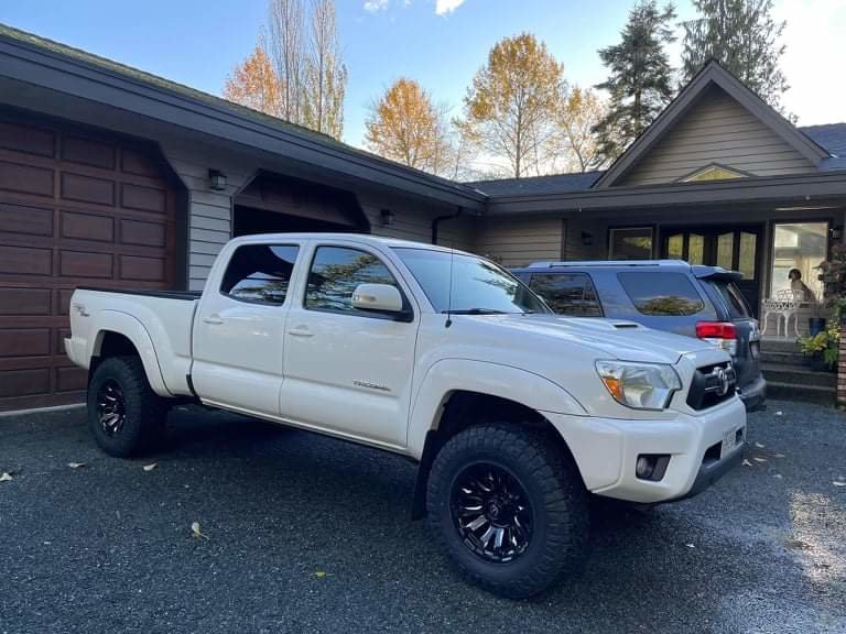

    Pics please!

    I appreciate all the responses here. To be clear to people who have mentioned the ratio between spacer thickness and actual lift, I dont know the actual thickness, just trying to get across i understand that the thickness of the spacer does not equal the actual lift distance, it very well must be less than 1.5", but i know for sure that the level kit i bought was 2". Further, i do not plan on buying new shocks and coilovers, especially after i have spent all this money getting to where it is now, just curious if anyone had an idea of what was going on. Dont have much in terms of pics of the whole ordeal, but heres what it looks like now:

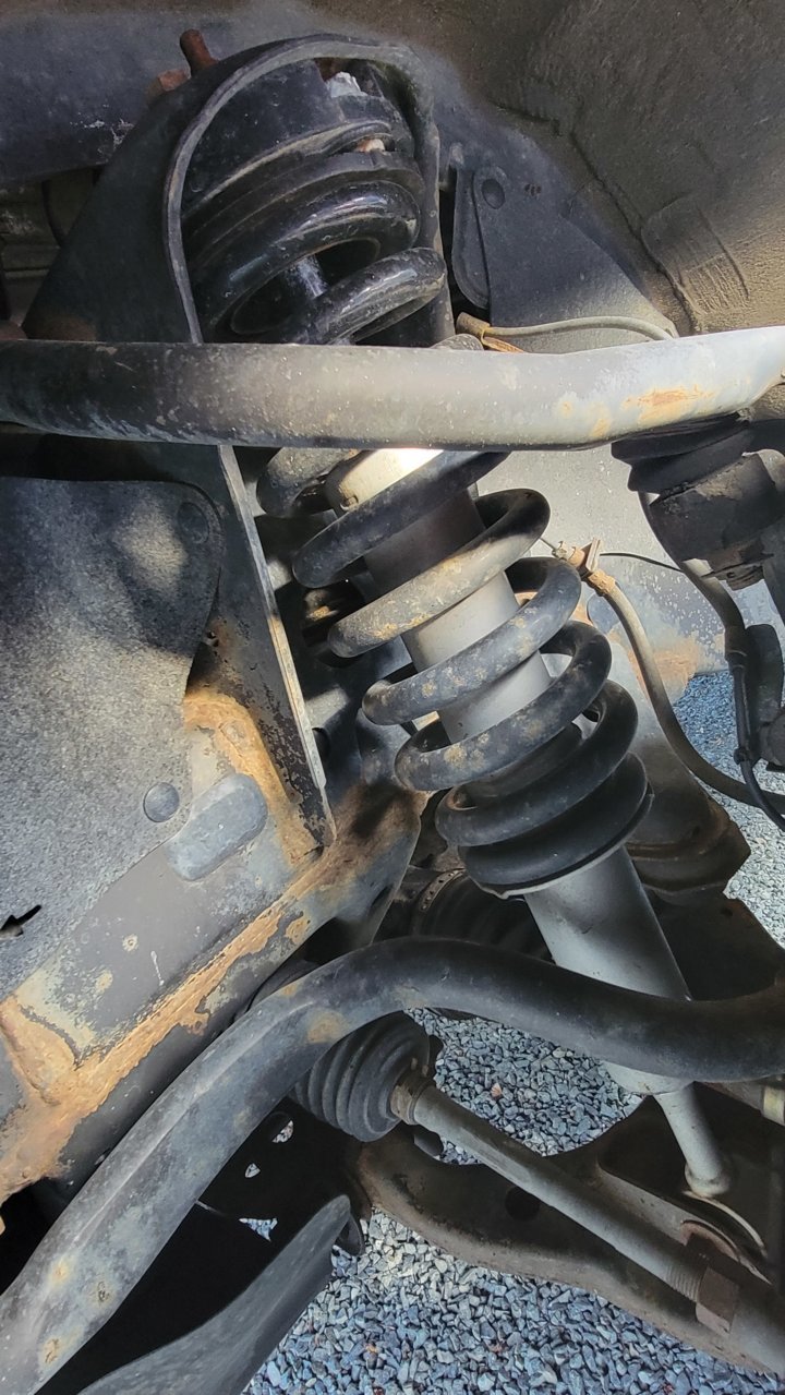

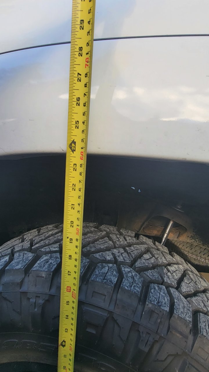

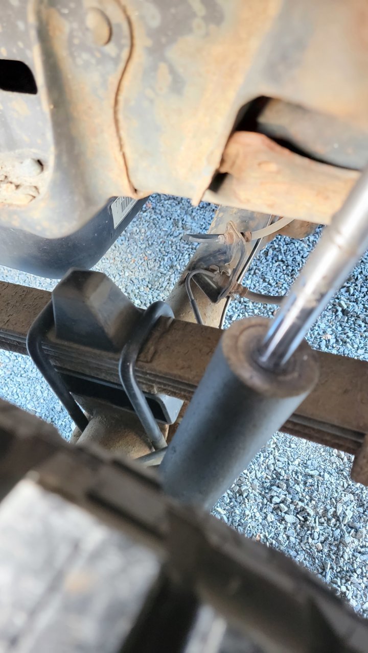

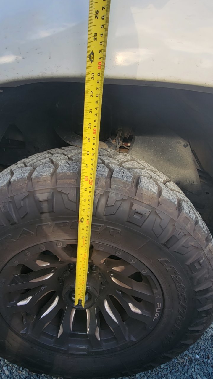

    I thought the stock rake was 2"? I assumed thats why all the level kits are either 2/0 or 3/1. anyways i just went out and took some pics, the measurements should be taken with a huge grain of salt as i was eyeballing to the centre of the wheel and the tape was pivoting on the tire, also its not on as level of ground as it could be. but here are the results:
    Rear driver side: ~23-3/4"
    Front driver side: ~23" (the pic was a bit low as you can see a bit underneath the fender)
    Front/Rear passenger: this is where things got odd, the passenger side was somewhere between 0.5" - 1" taller than the driverside. I didnt bother taking pictures because it would look the same as the others, but i remeasured all of them twice, and checked measurements from the ground to the fender as well, all consistent with being taller on the passenger side. once i have some level pavement i will remeasure. Also, the difference between the front and back measurements was roughly the same on both sides, and the difference between the sides was the same on the front and in the back.
    Front shocks and coils shown with spacer from my 2" level kit
    Rear suspension shown with stock leafs, spacer, and new shocks. New lift kit is Rough Country Suspension

    I don't see the issue here. Stock is what @Saskabush said, roughly 20" front and 21" rear so you're getting what you should. Lift heights advertised are always nominal.
    Nothing is weird with the passenger side being higher - it's the Tacoma lean from the factory weight distribution. Battery, gas tank, etc are all on the driver's side and most people get rid of it by installing a small 1/4-3/8 thick spacer on the driver's side.

    looks like theyre the stock front springs with spacers and regular old standard shocks..and rears are blocks with saggy sprung springs..looks like it is all installed correctly..

    the front shocks and springs are longer than stock

    So I'm seeing a ~1.5" thick spacer on top in front. And looks like a ~2" block under the factory leafs in the rear.
    Not factory shocks though... Is this the Rough Country kit on the truck right now? You mentioned your guy replaced the coils, do you know what coils he put on? Just factory? Rough Country? Normally the factory coils have little bingo dabber like paint dots on the coil somewhere but I can't see any from this angle.
    So there may or may not be some lift coming from the coilovers as well, depending on what exactly is installed. Regardless, if your measurements are correct you are basically at max lift in the front. Also kinda looks like you actually installed 3" lift spacers, not 2" ones. Typically the spacers actual thickness will be 1/2 of the lift it advertises. So if the spacer is 1.5" like you mention (and appears to be), that's a 3" lift. But on a DCLB you likely won't get the full 3". So I'm assuming the additional lift is coming from the coilovers.
    The reason you were having trouble getting above the amount of lift you currently have is because these trucks don't have much more than 3" of downtravel to begin with. When you lift your truck, that lift height comes at the cost of downtravel. Lift too high and your wheels will have no droop left. You can test this yourself by taking ground to fender measurements and then start jacking up the truck from the front crossmember until the tires just lose contact with the ground. Then measure again and subtract the first measurement. You want downtravel though, too little downtravel and your truck will "fall" into dips and holes rather than extend the wheel down into it and "catch" the truck as it falls.
    Now, I have no idea what your friend was doing. I think it's safe to say he had no idea as well. It didn't help that you are guys are trying to rig something up rather than just install a proper suspension lift. Basically there is no correct way to accomplish what you were trying to do. Spacers are already playing with fire and you were trying to get more lift by extending the height of the coilover assembly instead of adding preload to the spring. When you add length to the coilover, you fuck with the geometry of the independent front suspension. You can get away with adding a bit of length, but it sounds like you were trying to stuff an extra 2-3" of metal in there. That's simply not going to work well. And if you somehow manage to get it bolted up, it's going to ride like complete garbage and likely ruin your CV axels by pushing them out of their intended range of motion. You are basically at the max you can go with the setup you have. You won't get more lift in the front, you can get a bit more in the rear but I highly recommend ditching the blocks and going with a new leaf pack and shocks.
