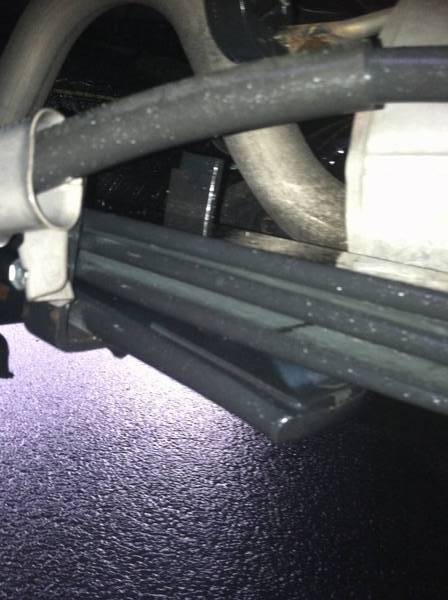

    No one can really confirm a rhyme or reason between models that get 3 and 4 leaf packs. FOR THE MOST PART, Double Cab Long Beds seem to have the 4 leaf, and Off Roads have the 3 leafs...thought process is the softer rear is better unloaded for offloading, while the sport is used more on street and to tow...but really, who knows...?
    13 DCLB TRD Sport here with the 4 leaf...
    When i bought mine, there was also a 3 leaf next to it with everything else the same. Same price, same equipment, same manufacture month in the door, same delivery date, and the only difference was the 3 vs 4 leaf. Almost signed the paperwork for the three leaf, and decided to check before hitting the finance office...dealership could care less which one I took, so I chose the 4 leaf...

    2013 TRD Sport Double Cab. Looks like four to me.
