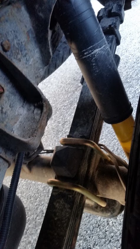

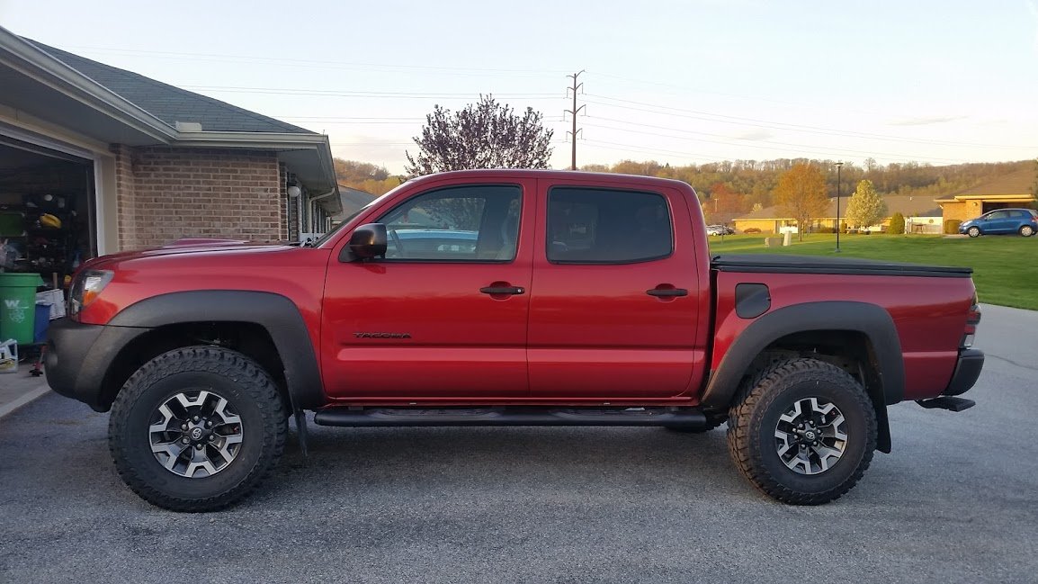

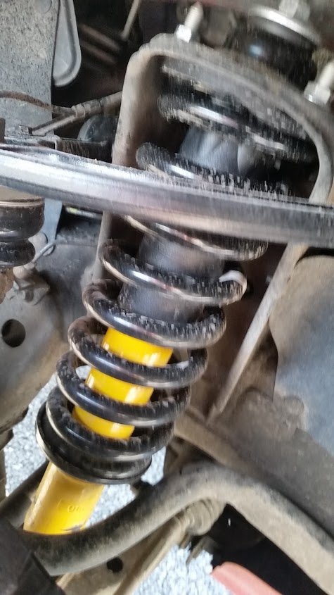

    I just installed a full OME kit with Headstrong's 3 leaf AAL this past weekend. I did the Nitrochargers Softrides. I dont run any extra armor/bumpers/etc, so i went with the 884 coils. I gained about 2" in the front and 2.5" in the back. I cant speak to the 5100s but the ride on with the OMEs has been fantastic.
    After install we took it for a quick drive on a very pot-holed dirt road to settle things into place before final torquing. I took the road a a brisk pace, and while you still noticed potholes, the ride smoothed out really fast.
