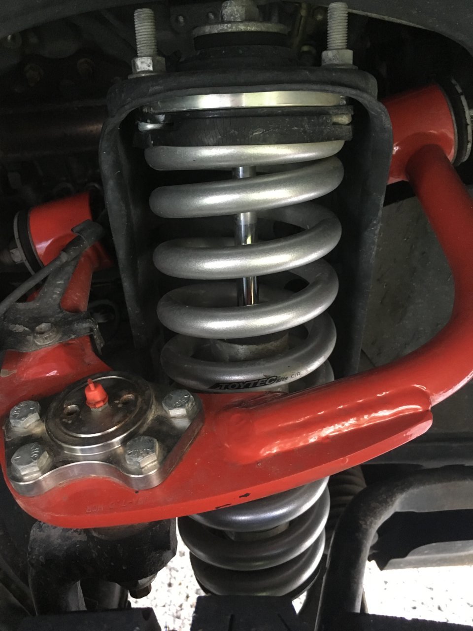

    Im running toytec coils, coil spacer, 5100’s and a JBA UCA in the front

    Its a 3 inch in the front and 2.5 in the back so it sits nice and level. It rides pretty good actually if I'm honest. It’s a little on the harsh side but I added a leaf in the back and those coils were way bigger and beefier than the stock ones so it’s what I expected

    YES! UCA’s are very important. Everytime i hit a bump with the stock UCA my steering would go all over the place. Its a must. And thats what I found. Once you buy one thing you gotta buy them all :hattip:
