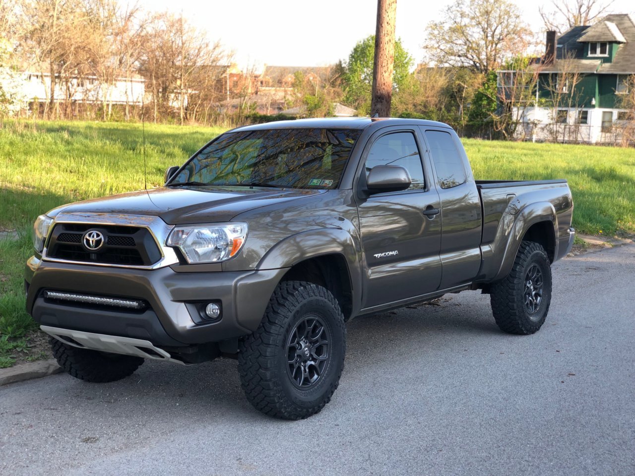

    Just installed 5100s in the front and really like the ride. I have the front set at the third setting (1.75). I will be putting them in the back very soon, cheers. FullSizeRender.jpg
