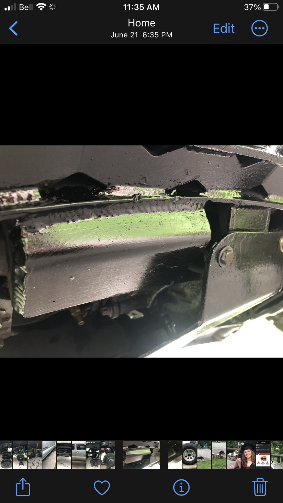

    Hey guys. Anyone encounter trying to change or fix front actuator with a Fabtech lift.

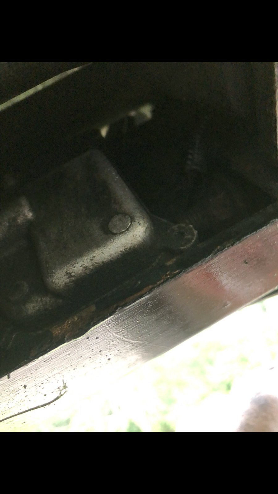

    The front crossmember has a guard plate fully covering the actuator. I can see it but def can’t get to those 3 bolts.
    I’m fearing I have to take off all front crossmember parts just to get at the actuator.
    Hope someone has encountered this.
    I’ve spoken with Fabtech head office and they have never heard of anyone having this issue and didn’t give me any solid advice.

    Thers actually 4 bolts, top left very difficult to remove

    Ok yes 4 bolts but how to I get to them with the armour plate right over the actuator.

    Wish it was that easy. The plate is welded to the front crossmember.

    Hate to say, you might have to remove crossmember, or drop front diff.

    Yeah, I think you are right. Not to confident on using angle grinder to cut off plate and re-weld. Thanks for the replies
