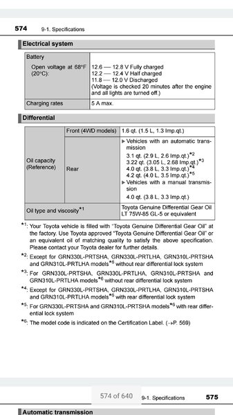

    I'm trying to figure what type of fluid I need to replace the front and rear difrential fluid and the transfer case the dealer was no help in trying to figure out what I need I have the crush washers and stuff to replace them and does the rear dif need the lsd additive any help?!?!

    Its all in the owners manual

    For the diffs, use either toyota 75w-85 gear oil or redline 75w-85 GL5, full synthetic no additive needed. Refer to owners manual above for the correct amount. My advice is do it all yourself.

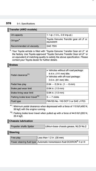

    To hijack the thread a bit, I just had my transfer case fluid changed at Toyota and the service notes state "3.4 pints 75W-90 Gear Oil" for a total of $16.80.
    Can anyone tell me the difference between 75W LF (toyota fluid) and 75w-90? The whole reason I went to the dealership to have them perform the change was because the 75W LF fluid is like $55 a liter.
    Also, 3.4 pints equals 1.7 quarts. Manual calls out 1.1. Going to talk to the service manager tomorrow, in addition to how to proceed about my transmission being 3 quarts low.

    Manual calls out GL-5 or equivalent, so that's why I say that.

    Why does the transfer can call for 75w?!?! So do I just look for 75w oil or do I use 75w-90?

    In the onwers manual for the transfer can it calls for 75w I'm trying to figure out if it's just 75w gear oil or 75w-90 or75w-80 and so on!

    75-90 for all 3 and be done. No LSD additive needed as there is no mechanical LSD, only the brake controlled LSD. Synthetic or conventional is completely up to you. I get Mobil 1 75-90w cheap from a local wholesale place so that's what I use. Will take 6qts to do all 3.
