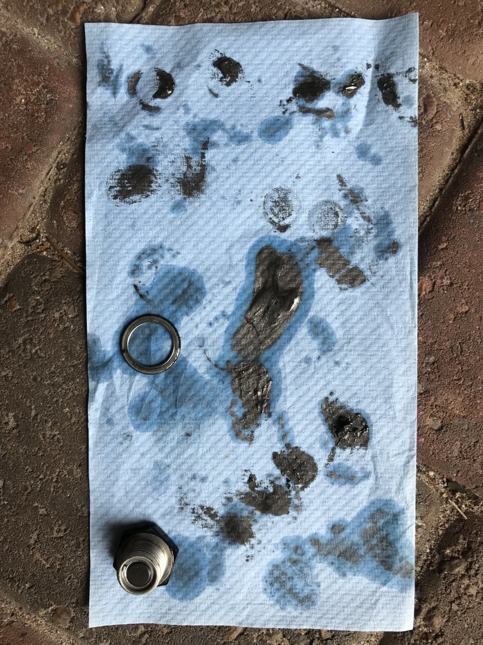

    Are those the shavings off the plug magnet?
    I had a grape size amount on mine when I switched the fluid. I didn’t see any chunks though and I could’ve find any in your pic but maybe I just don’t know where to look.

    That's the metal particles on the the magnet he wiped on the rag. It's common to see that after break in.

    As does the SR manual

    That’s the normal amount of metallic paste off a new diff magnet at first oil change. Mine was pretty much the same, no issues with the diff. What am I missing?

    Yeah it seemed excessive but I’m not too worried about it. Now if at my next oil change I see it again...
    My rear end also howls like a banshee but I’m not sure the two are related.

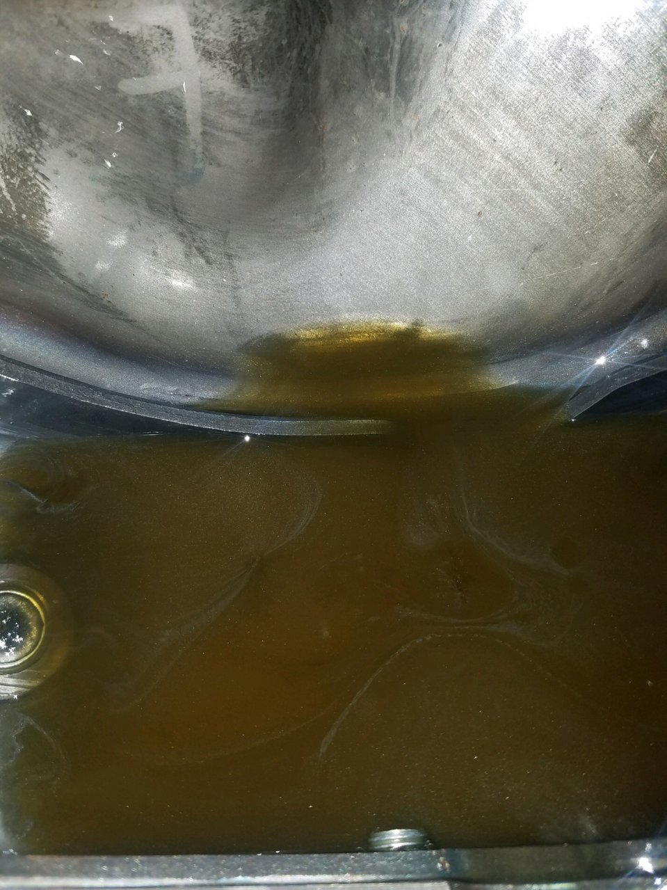

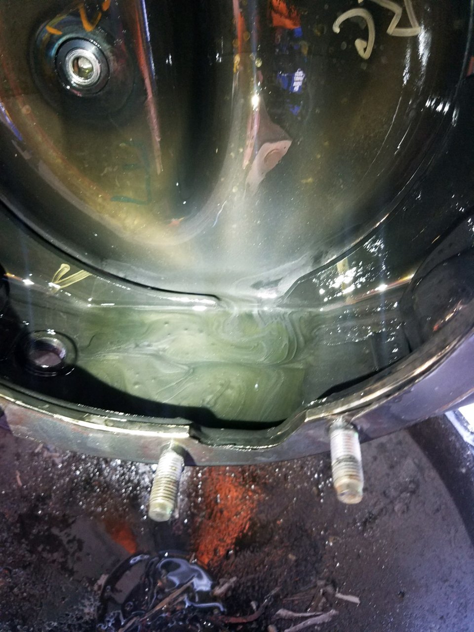

    Yea if that was the first time I had changed it I would have been fine. I’ve always had a noisy diff and I beat it hard with my 285s. That was my 3rd diff fluid change (on factory gears), and all three looked like that. I changed it everytime the rear end was submerged. When I swapped to nitro I didn’t have anymore that looked that bad.
    Disassembled after 10k miles (since last fluid change) to do nitro swap. I consider this excessive:
    What I’d consider normal:

    Ok. That’s good info. I was thinking it would was just your first oil change.
    Thanks for the update.

    Yeah that’s goofy. I’ll have to check mine again. I don’t wheel much in this truck though.
