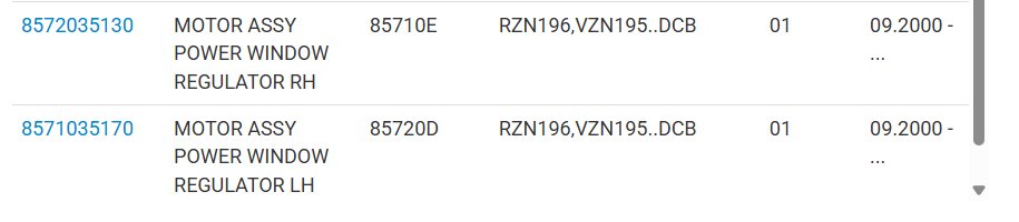

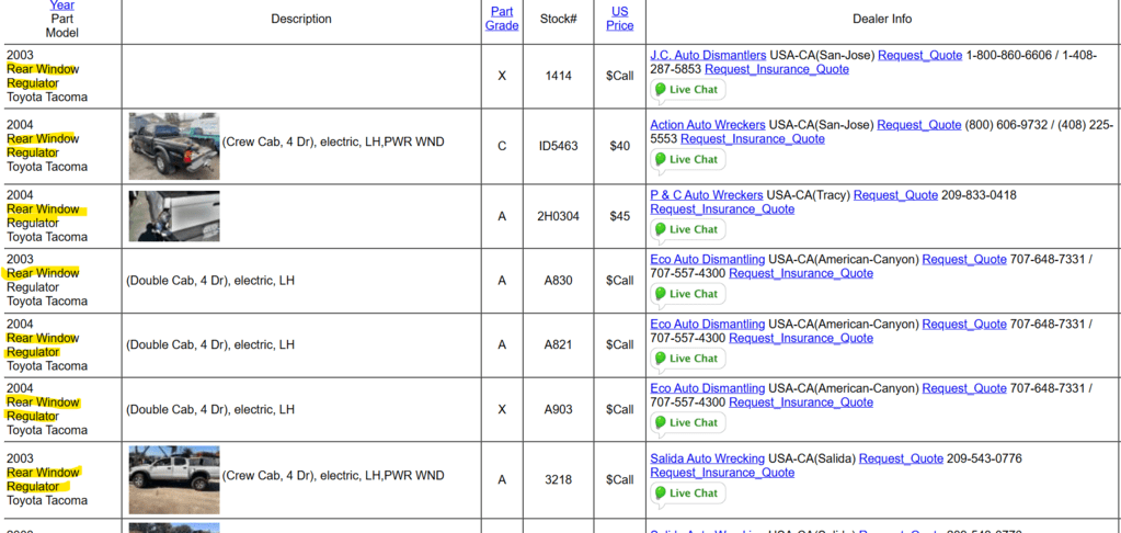

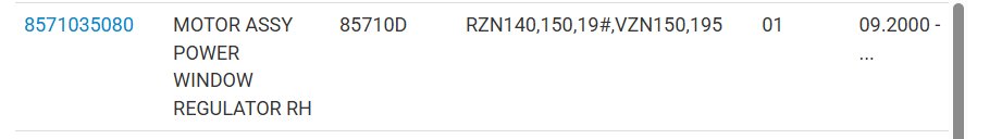

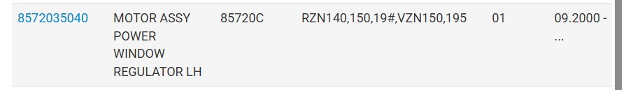

    Different part numbers between front and rear so my gut says nope, won't work. This might be a www.car-part.com item. :(
    Front
    Rear
    quick search of www.car-part.com comes up with -
