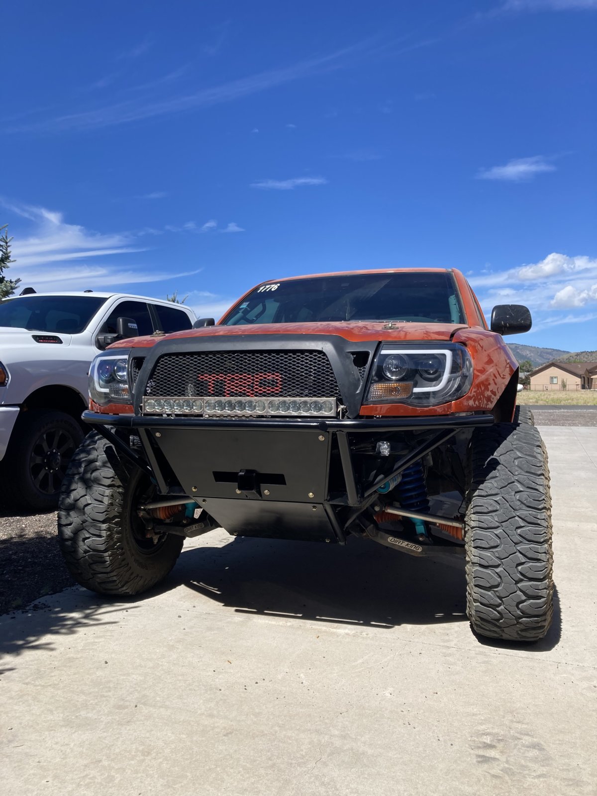

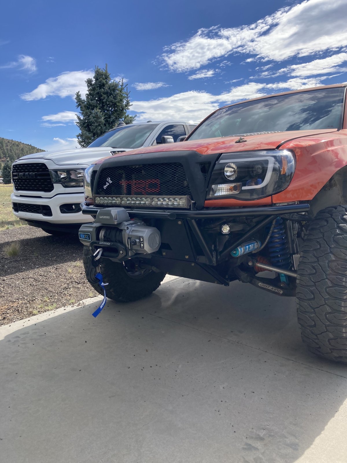

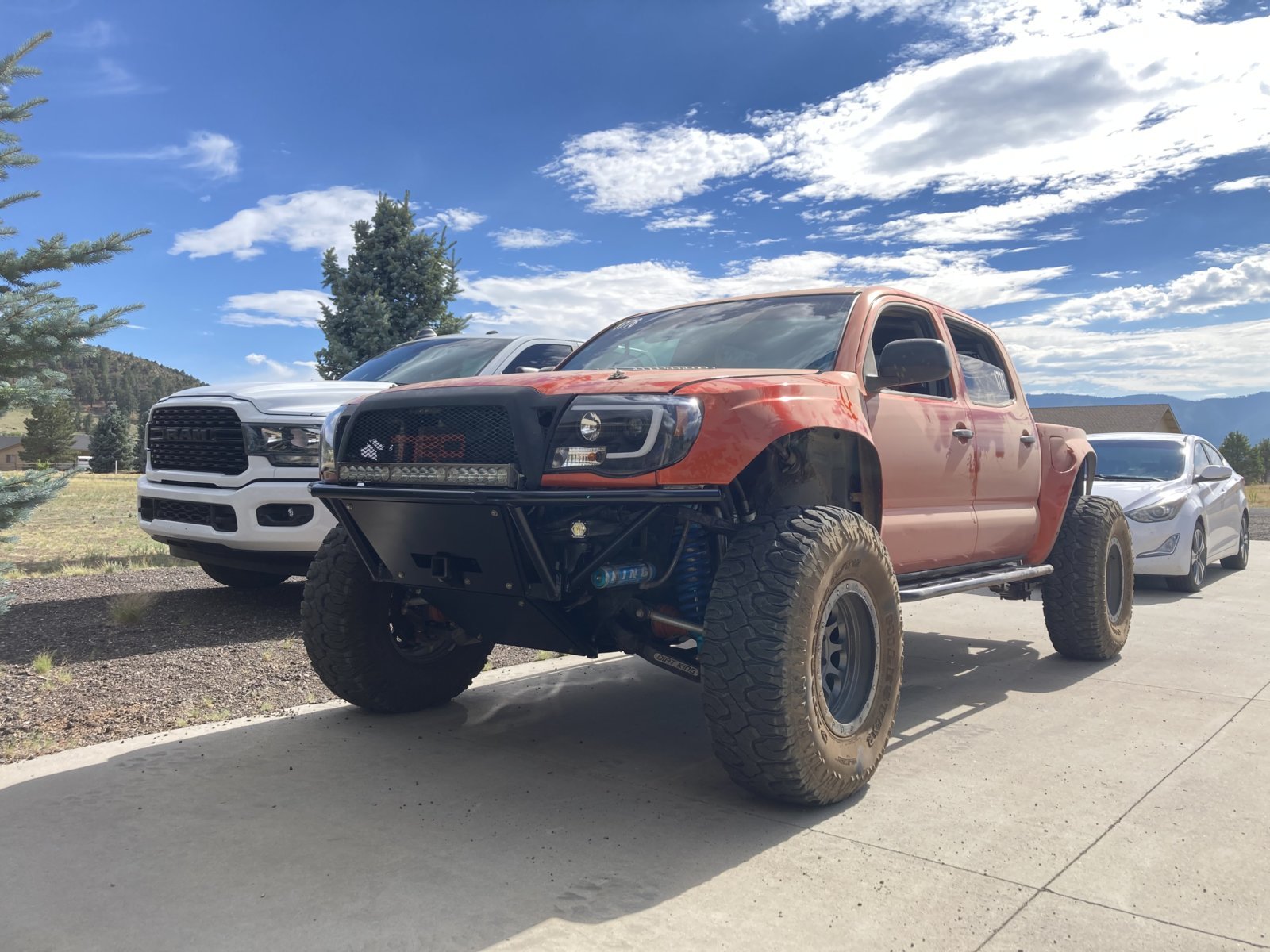

    I think building your own is the only option. @snowsk8air2 made a good lookin one

    A guy in my *own backyard*.
    Well how about that.

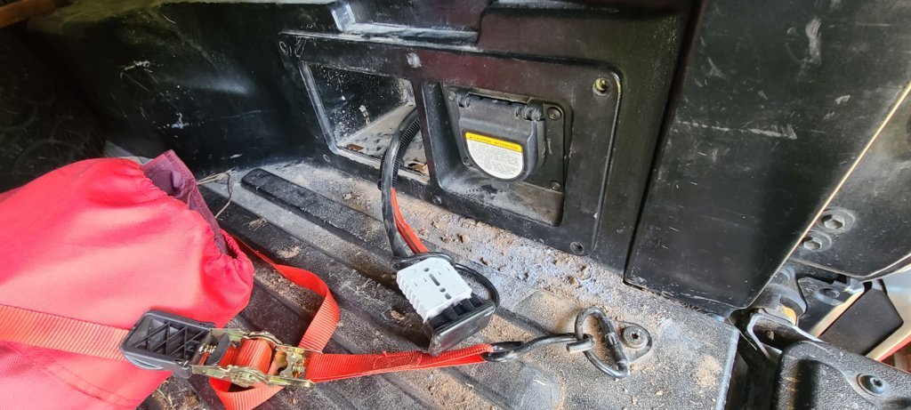

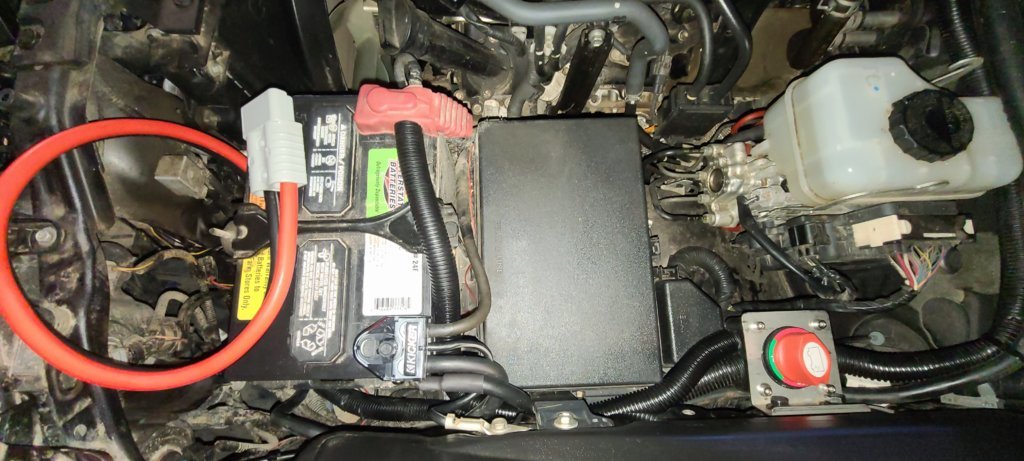

    I finished wiring up for a front or rear winch this weekend.
    I like the option of being able to use it front/back and not having to always keep it on the truck.

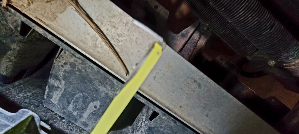

    I had to check.
    5" on the tape measure gives the winch arm comfortable enough room before touching the grill.
    The other end of the tape measure is right on the back side of the stock aluminum bumper.
    The pin (to center) is 1.25" from the end.
    Looking down at the bumper.
