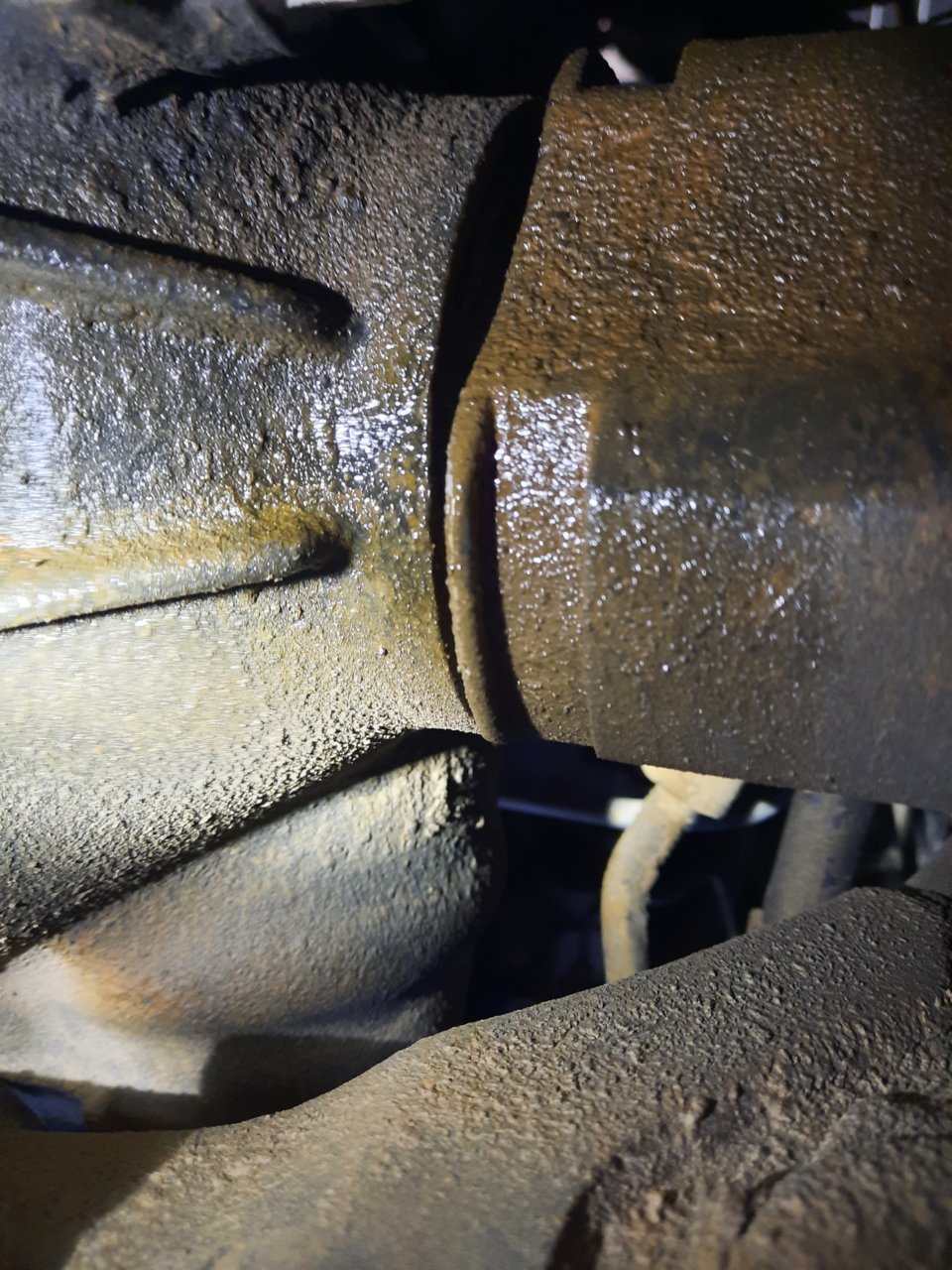

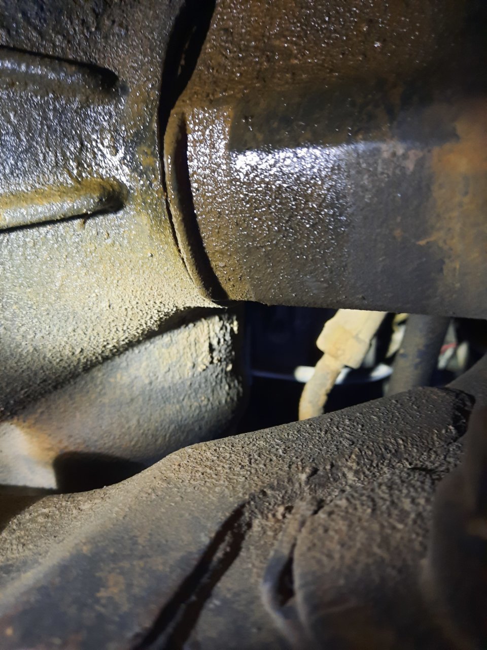

    So obviously this is a front axle leak, but what component is most likely leaking? This is on the driver's side. This is a 99 Taco with 4x4 and a 5 spd20220324_155607.jpg 20220324_155600.jpg

    Seal, found in my sig :burp:

    Could be leaking from your PS lines as well. Dripping toward to the clamshell. The ps line are within that vicinity. Something worth checking

    Smell it. Gear oil smell... unmistakable

    Looks like what everyone is saying, but I would clean the area to verify. Even if it's great oil, could be coming from the breather.

    A stuck breather can also cause or contribute to an oil leak at the seals. Make sure yours is free to open.
