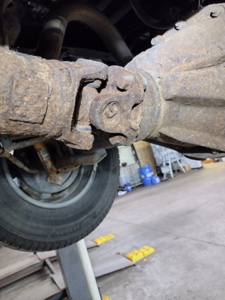

    Hey all. I took my 2017 Taco in for 70k-mile service. I drive about 7000-9000mi/yr, mostly in New England but last few years in Mid-Atlantic. For $343 a local shop changed oil, rotated tires, torqued driveshaft and axle bolts. Said all looked good except they were surprised there's give on the driver's side front axle where it connects to the differential. Here's photos they sent:
    Here's a video demonstrating the wiggle: https://youtube.com/shorts/X49Apvf7LgM?si=y-qdHxKSxA_p221s
    To fix this, they recommended Remove & replace CV axle assembly ($580) and 4-wheel alignment ($191). That should suffice but they warned I might also need to Remove & replace differential carrier ($1,378). They said it doesn't seem critically urgent, it drives fine and they saw no other issues or leaks, but they said to keep an eye out for any fluid leaking in that area in which case it is more urgent to fix before driving.
    This axle problem is surprising to me. I know the truck got rusty from New England winters and insufficient car washing or undercoating, but it seems early to need to replace an axle assembly. Also, back in January around 64,000 miles, I had a 4x4 error code fixed (truck would not engage 4WD) by a different shop that replaced the differential vacuum actuator assembly (part $545.22 and labor $240). Though this axle and the differential actuator are separate parts, am I understanding correctly that replacing the differential carrier would mean it was a waste to replace that actuator?
    Wanted to check with y'all as more knowledgeable car/Taco folks than me. Is this a surprising sign of early wear and tear? Or is this more normal than I think? Do prices seem reasonable? And how urgent would you think this is to fix?
    I bought this truck back in Sept '16 largely due to Tacoma's outstanding reliability. I'm not handy with cars and needed a truck then (less so now, but it sure is nice to have). I tried taking good care of it, I follow the service schedule and now wash it a few times a year. If I'm in for more trouble ahead given all this rust or whatever is wearing this down faster than expected, I'd appreciate a heads up, as it could be time for me to sell this to someone who won't find that as much of a hassle.

    This shop is charging you way too much. "$343 a local shop changed oil, rotated tires, torqued driveshaft and axle bolts" should cost maybe half that.
    Replacing the CV axle is unlikely to help anything. Looks like the bearing is bad. It's relatively easy to replace.
    Edit: it would be a good idea to drain the front diff in case any parts of the bearing could not be located. And I would avoid using 4WD until it's fixed.

    That's completely normal for these trucks on driver side. If it's not leaking or making noise, then you can leave it.
    The method to make it wiggle less is to install the ECGS bushing. It has many benefits and will outlast the stock needle bearing.

    was this a toyota shop? assuming not because this issue is so common just about all tacoma owners know about it. the play is from the needle bearing inside the diff. your cv axle is fine. only thing you need is the east coast gear supply bushing. also no need for alignment

    They can replace the CV axle. But it won’t fix that play.
    I’m surprised the dealership doesn’t know this……..o_O
    Or do they, but think you didn’t know?
    Unless you have a vibration. And it GOES AWAY in 4WD.
    Leave the axle and bearing alone.

    The reason I asked them to torque the driveshaft and axle bolts is because that's what I saw for 70k in the service manual. They said the bolts were all fine as is.
    Glad to hear from you all that this is normal. As for the rust, I plan to get a wash and then undercoat spray before this winter. The rust is already there but any tips on how to minimize harm going forward, I welcome your input.
    Yeah, I also thought it was pricey. This was not a dealership. My usual mechanic was booked out for a while and I wanted to get this work done before a busy streak on my end. This other shop mostly works on European cars but is generally good. Guess that explains why they weren't familiar with this normal wiggle room (assuming good faith they weren't just trying to dupe me into more work).
    From other responses, it seems like no one notices an issue and that it's normal for the needle bearing to have some wiggle to it. Could you tell more why you think the bearing looks bad?
    Also, others mention replacing a bushing, sorry for my ignorance but is the ECGS bushing equivalent to the needle bearing (as in, the ECGS bushing would replace the needle bearing)? And if the needle bearing seems to explain this issue, anything I should look out for to know when it's worth getting that part replaced?
    Thanks for sharing your insights!

    yea the bushing replaces the needle bearing. gets rid of the slop and it often gives a vibration when going bad. mostly in lifted applications but seen quite a few people have issues even stock height. this has been an issue on tacomas from beginning in 1995.

    It looks like a lot more play than I expect, although I haven't tried to wiggle mine to see if it's loose. So don't take my word for it because I don't know what is normal.
    The ECGS bushing would replace the needle bearing. Is your truck lifted? Having a lift can cause the needle bearing to fail faster.

    The bearing isn't bad they are all like that.

    There is also the same play after installing the ECGS bushing.
