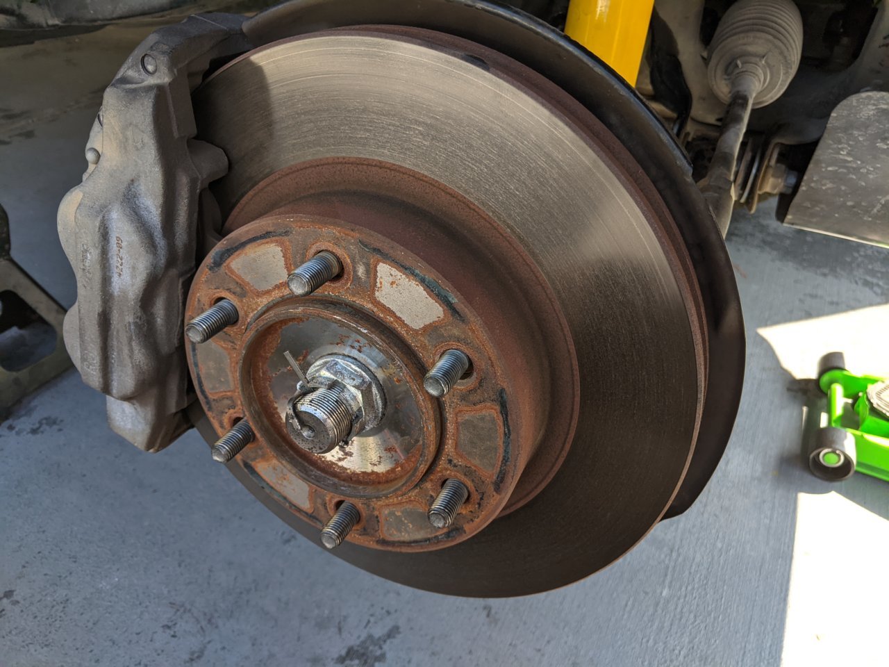

    The question is, do all of our trucks have the same axle nut style? Or was there a change somewhere in the model years? I have 2015 DCLB 4X4 auto, tow package.

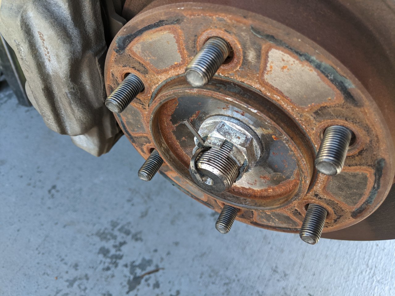

    I rounded up all the parts to replace it, and low and behold when I went to take the axle nut off, it was 36mm (~35.7mm measured with a caliper). AFAIK, all 2nd gens should have 35mm axle nuts--and unfortunately for me, I had a 35mm socket, but not a 36mm socket, so the new CV shaft will have to wait until tomorrow.
    In addition to being 36mm, it's also a castellated nut and not the standard plain flanged nut+the castellated nut cap.
    To me, this looks like a non-OEM replacement the PO did that used some funky nut size, but I wanted to confirm.
    Let me know if anyone else has seen this.

    You are correct in assuming that’s a replacement axle. I did a replacement a while back with a Napa axle and that’s the nut that came with the replacement. That would explain the failure you had.
    edit: the axle was purchased at Napa but was labeled “FVP parts”.
