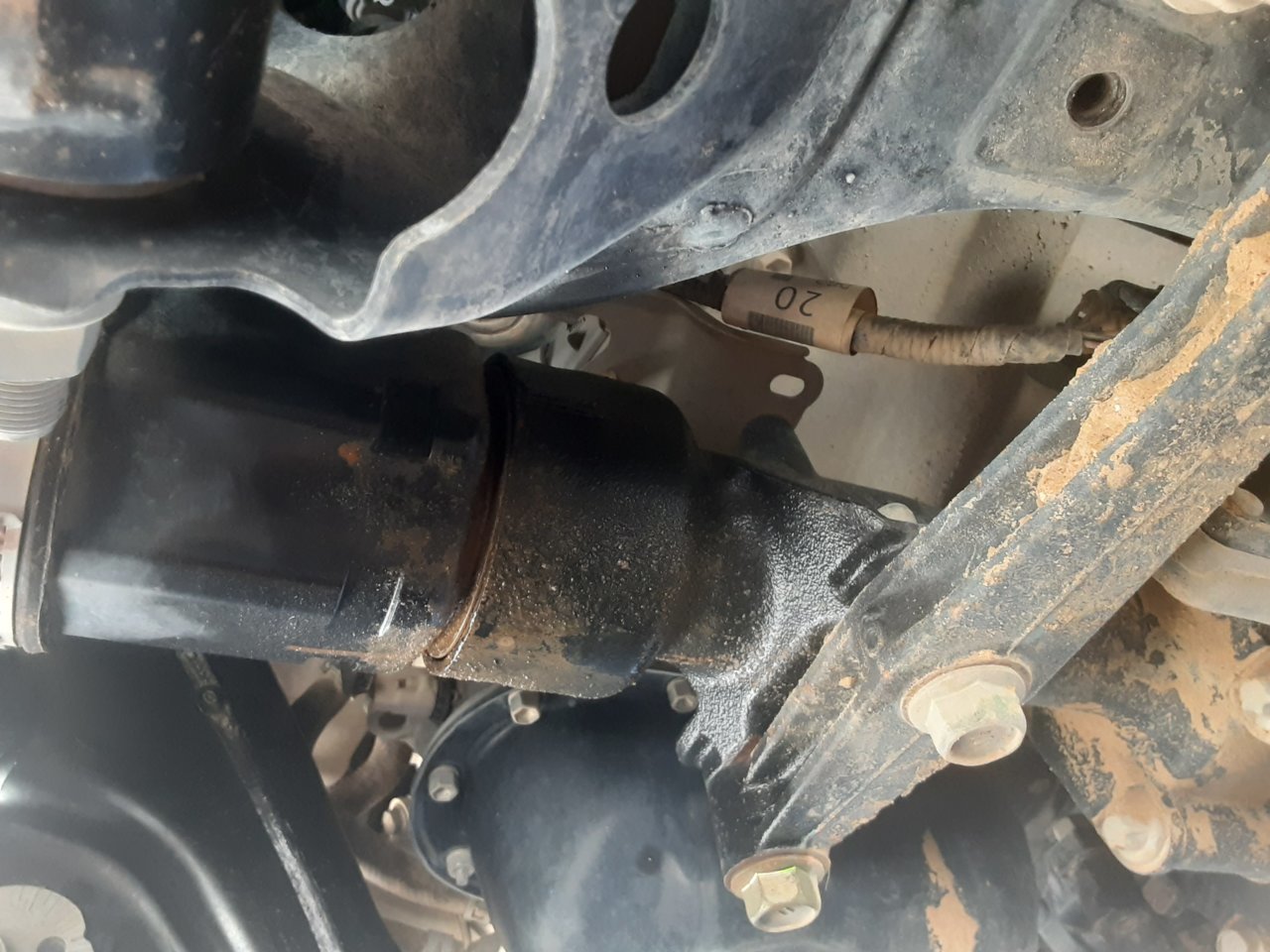

    I know its not good. anyone have any idea of whats leaking?
    Doesn't stink so I didn't think it was diff oil.
    I have 60k powertrain warrant so I will bring it there.

    It's gear oil. CV shaft oil seal in the end of the housing. Not that big of a deal.

    That is a seal leak for sure. Should be covered, I had one go bad on my truck and it was covered under the warranty. If you do it yourself make sure you don't push the seal in too far or it won't seal.

    Dealer chose to not cover it because it had rocks and mud. Nothing to do with lift.
    Lost $100 on diagnostic. Yeah it was the axle seal.

    So I spoke with the guy yesterday. I asked him directly, if you tell me because I have offroaded in the past this isn't covered, I won't do an inspection. So he says they will look and if it is obviously from offroading, like a torn CV, then they will not cover it. I know its an axle seal since the CVs are intact.
    Today he tells me since its been offroaded they can't cover it. Not that the seal is obviously broken from offroading. It just can't be covered because offroading voids warranty of a TRD OFFROAD.
    They didn't even check the diff oil level and told me it can't be done without draining it (untrue).
    I am going to cancel the charge since they lied about the charge conditions.
