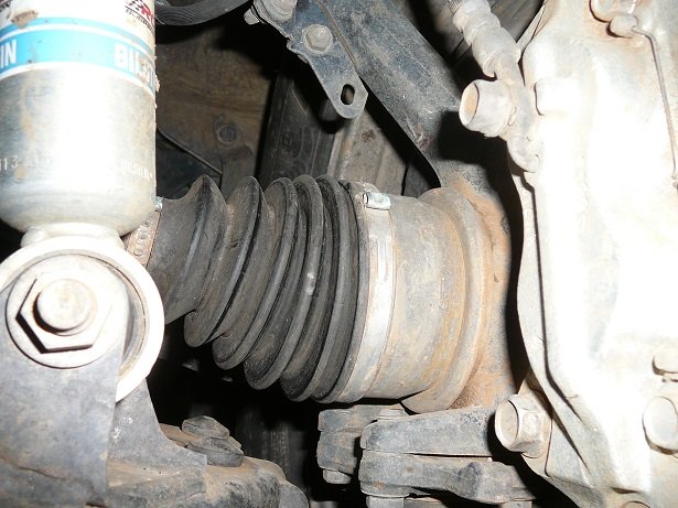

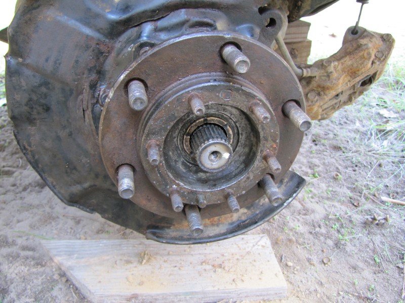

    I took the hub assembly to a machine shop and had a new bearing pressed in.
    Now the drive axle is too short to reach into the locking hub.
    What am I doing wrong?
    What keeps the boot assembly pressed up against the hub assembly?

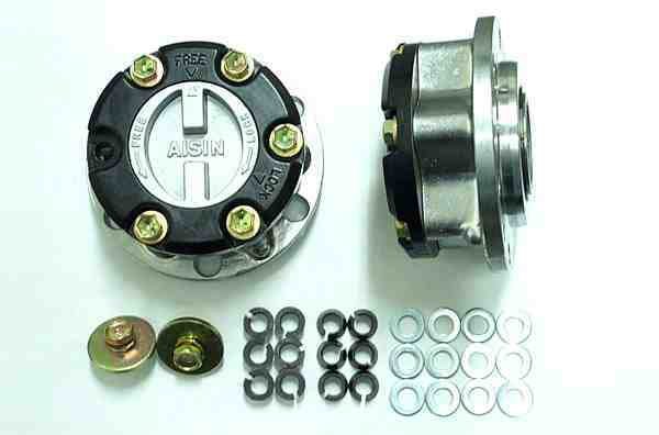

    He does. That's why he's asking and the other link he posted shows his axle with Aisin manual hubs.

    It doesn't look like the axle is seated all the way in. Looking at pics 3 & 4, it seems like it should seat a lot closer to the spindle

    When the axle is pushed all the way against the inside of the hub assembly, the splines are probably an inch too short.

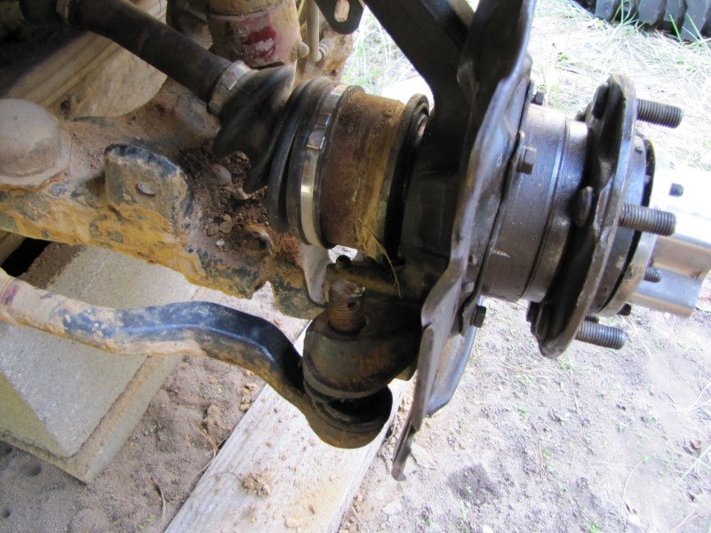

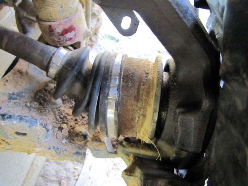

    As a reference, my driver-side CV looks like this:

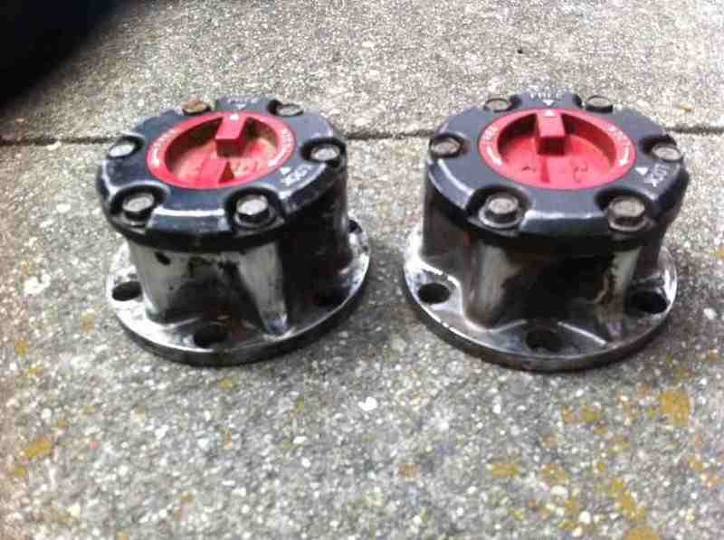

    Looks like you have the wrong manual hubs (86-95). There is a specific Tacoma manual hub (95.5-00) that is not as deep as the earlier style.
    Something doesn't add up.....
    Did you just buy those manual hubs ? (they look clean).
    Post pics of the other side if you haven't taken it apart yet.

    That's what I was thinking. My manual hubs look shallower that what I'm seeing in the pic. Like you said, since the hub looks so clean inside, I'm wondering if these are new hubs that are being installed.

    Early ifs non-Tacoma hubs
    Tacoma ifs hubs
