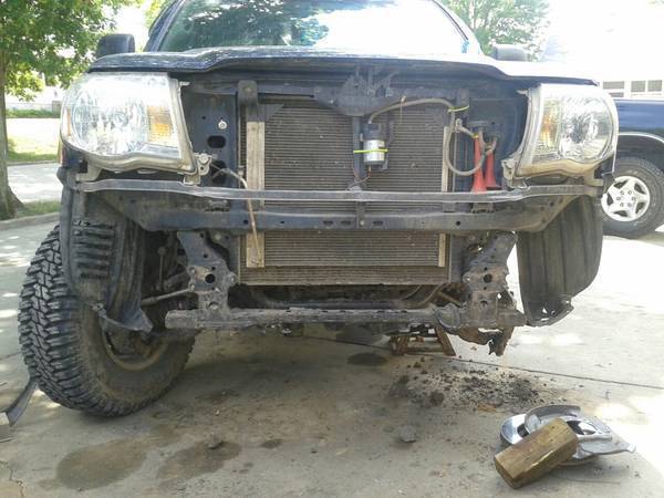

    just for shit sake[​IMG]
    22r next to 2tr-fe
    cool oil loom for the cams in the 2tr-fe
    my dog loved the fold down seats in the sr5
    engine bay of 2nd gen taco minus engine
    r155 5spf from second gen taco
    towing a dodge that blew up in a hole I drove the Taco through. Rods through the block at 50k miles
    idk, but check out my drift charm :)
    bumper I made after trashing my stock one
    toyed with the idea of my 35 boggers on the taco..
    should have gone with boggers.. lol
    is this not the parking lot?
    driving the 81 while derping the 2013

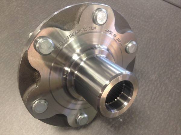

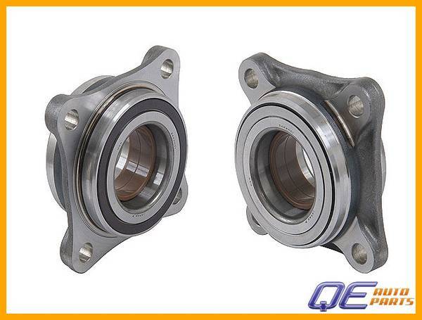

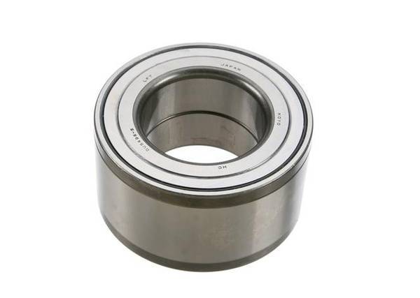

    ^^this is the bearing if you buy just the bearing

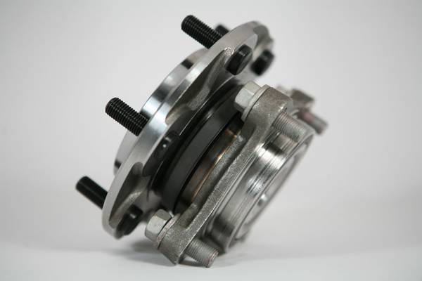

    ^^ this is the entire assembly, the hub with the splines is pressed into the bearing that is pressed into the bearing flange.
    And like magic. The evil that is called a unitized hub bearing.. FML.

    I forgot the other two.
    just figure putting pictures of the parts together could help anyone who does not know.
    ^^ this is the stub where your cv splines are held in and drive you wheel, this gets pressed in the bearing.
    ^^ this is the bearing flange with the bearing pressed in. Autozone has them over the counter like this.
