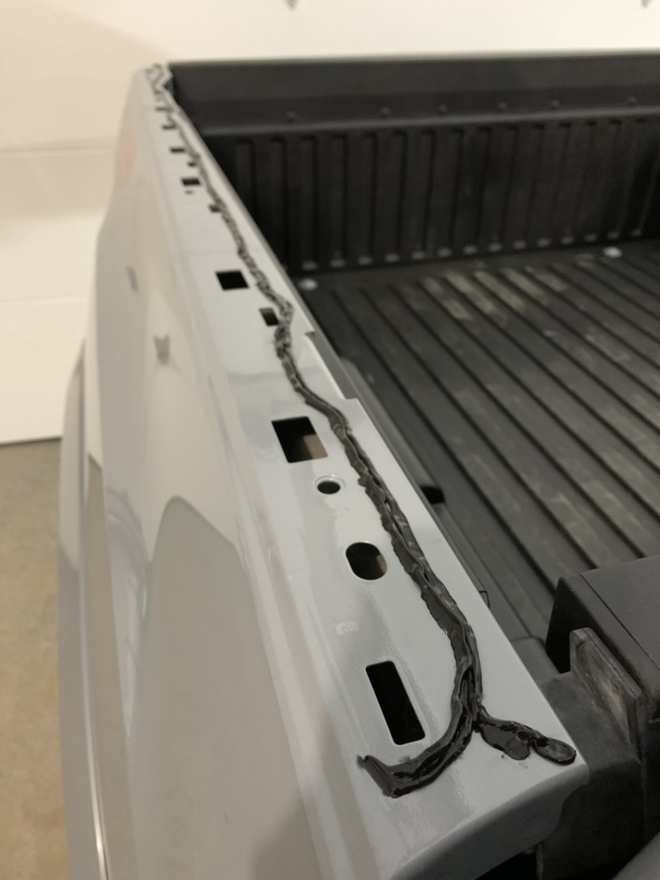

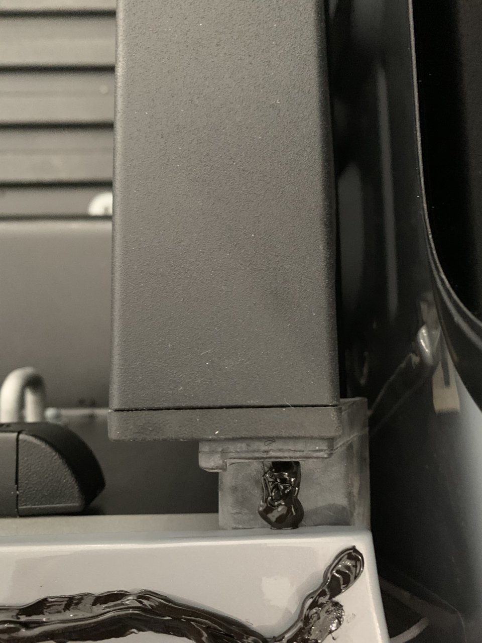

    What I’ve found with the DB is that you need to progressively tighten it down as the gasket settles and forms over the bed rail caps’ variations. Same applies to the front rail. So far there has only been a very small amount of water get it through the front and I’m pretty sure I’ve got that sorted for good now (got the wife to lie on the panels as I tightened them).
    What I also did was install the factory rubber plugs, which requires taking the bed rail caps off. Since they were off, I ran a bead of silicon on the inside edge - no water has got in that way. You have to trim the bed rail cap a little to get it back on over the OEM rubber plugs and then fill the small gap on top with silicon. Some pictures below.
    I’m pretty happy with my DB as it is well made and it’s the only cover on the market that fits our needs. Like most things, just a few tweaks required and the instructions do say that you need to adjust as the gaskets settle.

    Exactly the information that I was lookin for. I was going to seal under the bed rail caps too. I have the factory cover so I want to replace them also. My thoughts were exactly as yours, slow even tightening of all three parts of the diamondback. I’ve seen pics where some have tightened down the center rail so hard that the rail caps started to deform. No need to go nuts on it like that but keep all the tightening equal between the access doors and the center piece.
    I think that’s a great thing about that cover is the adjustment on the tightening until everything settles in. which version did you go with?

    those appear to be for filling the gap between the front and side rails but I don't see how they could help with sealing with a height difference.

    Nope. The square tube sits on top of the header board.
    Most tonneaus designed for the 3rd gen have a thinner seal at the front to account for the difference. My Extang Encore is like that.

    That’s correct but with the Diamondback’s, the gasket seal deforms so the height difference, in mine at least, is no longer an issue.

    Leaning towards the SE smooth. What did you use under the caps, looks like silicone? There’s a couple threads here where the weatherstripping on the hinge side at the center appears to have been cut short, hopefully that’s no longer a problem. I’m about 90 minutes from the factory so if there’s a problem I’d assume I could have them look at it.

    @cop414, yup just black exterior window/door silicon. I let it fully cure before putting the cap rails back on. That gap issue between the centre panel and panels seems to be diminishing with mine as it gets tightened down - I’ll likely just have to add a couple of small weatherstripping patches but we’ll see if it’s necessary. And yeah, they ain’t cheap - and I’m in Canada so that added another 25%!

    Elongating the bolt holes on the front rail in an attempt to drop it down to match the height of the bedside tops will not accomplish anything. The square rail itself is what sets the height from the top of the composite bed tub.
