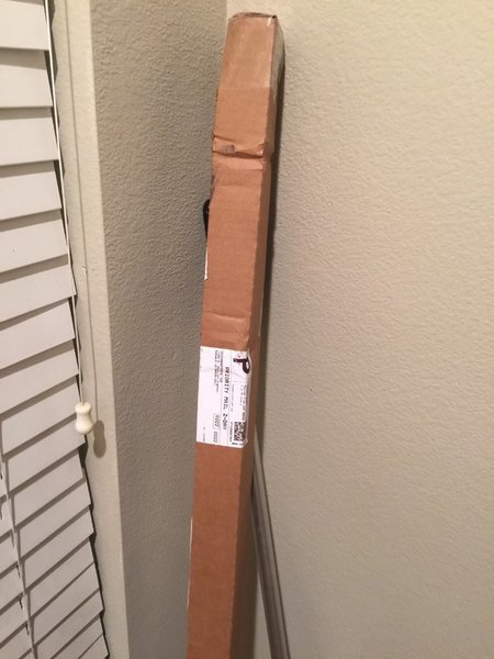

    Received my rail today!!! Will be installing (hopefully) tomorrow!!!

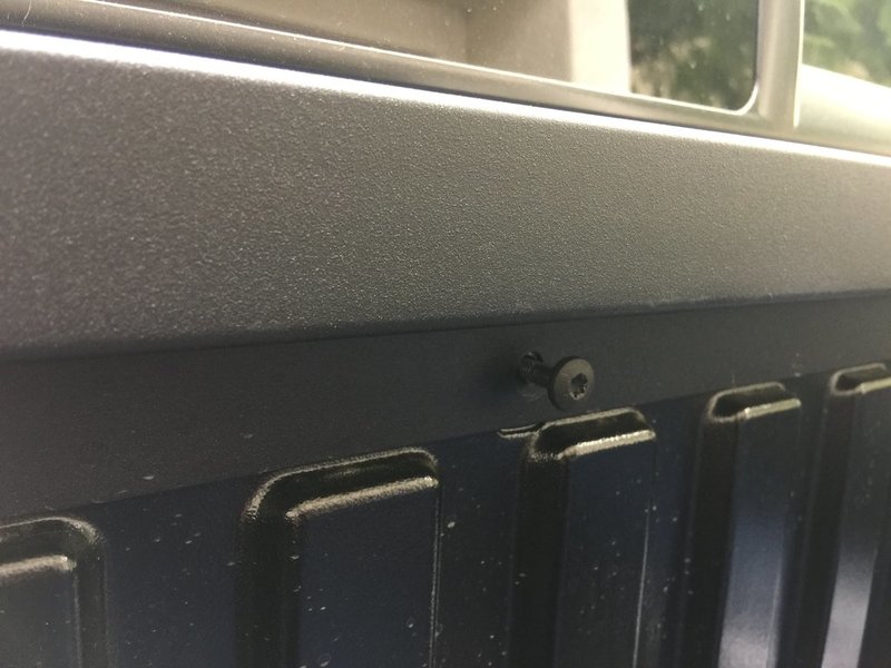

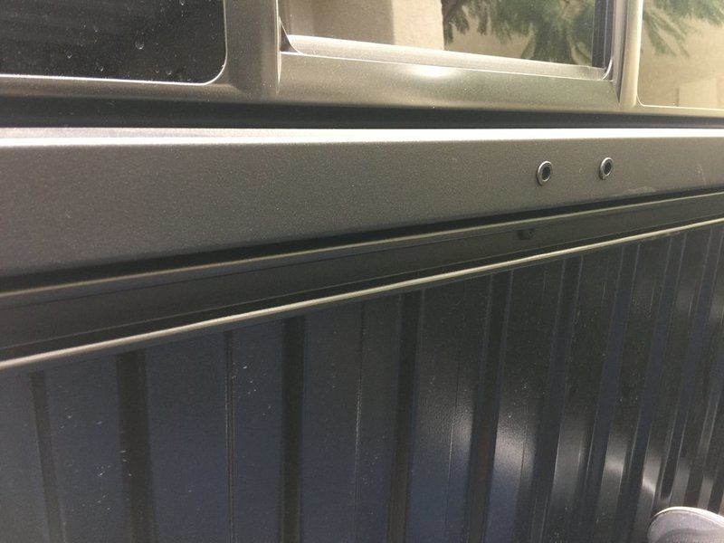

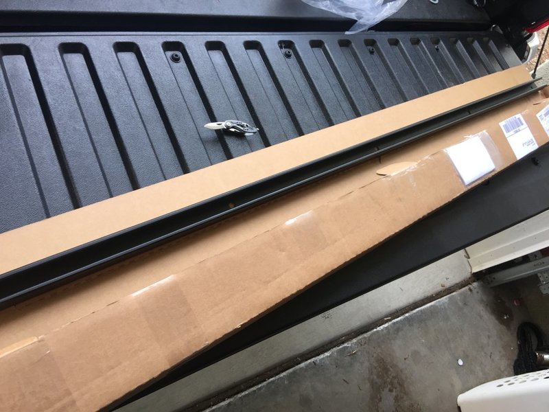

    Just finished the install. Took about 5 minutes to do. Not difficult at all
    Opened Package
    Removed existing screws
    Aligned new rail with existing holes and install the screws that were removed..and that's it

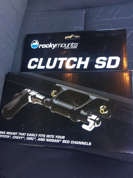

    I installed mine so that I can attach a Rocky Mounts bike clutch and also so that I can have more tie down options with cleats

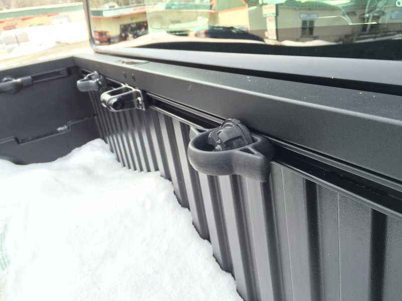

    Here is mine with Rocky Mounts Clutch SD and 2 additional OEM tie down cleats
