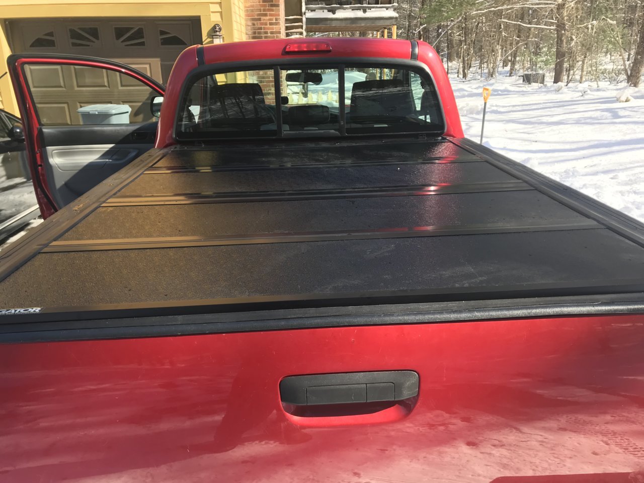

  6. Feb 27, 2022 at 10:24 AM

    Do you have to remove the side rails to install this or did they get lowered?

    Side rails stayed put. The FX3 has it’s own rails that mount on the factory side rails. The front bed rail needs to be removed or it gets in the way of the front mounting brackets.
    It’s a nice cover and I got it for half price direct from Gator on eBay. Not completely dry but I can’t imagine anything is.
