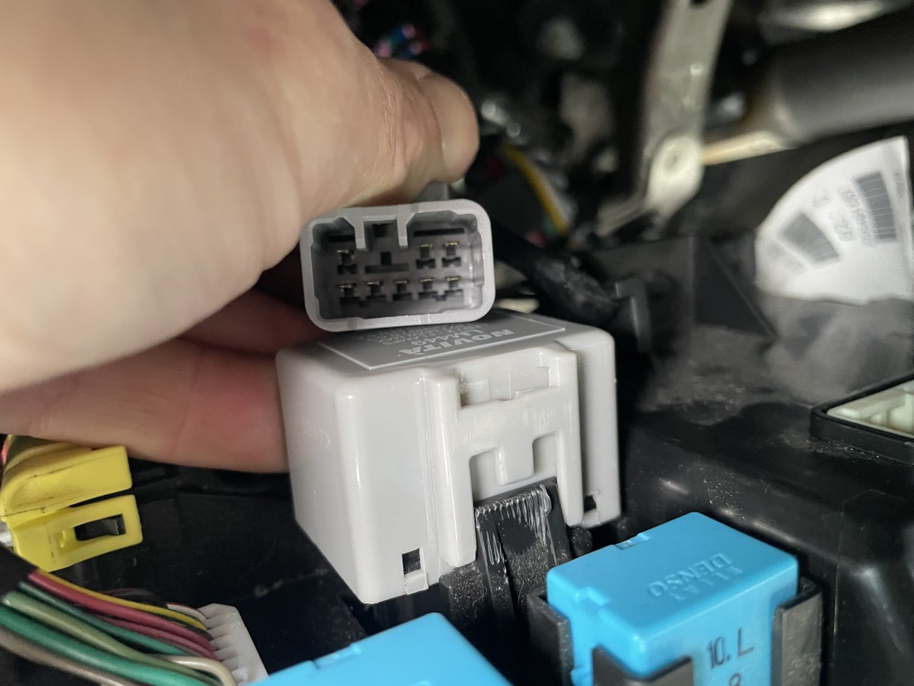

    Hello, I recently came back from a 6 month trip to find out that my front turn signals were acting up. I replaced both bulbs, installed a relay and now only the rear blinkers are working and the front two aren’t measuring any voltage on my external volt meter. The relay I installed was Novita LM449 and that required me to unplug a connector and install the relay in place of the wiring connection. The “flasher” relay is still in place however. All fuses checked good.

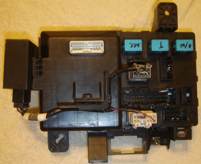

    If you have the 12 pin (DRL/Tow Package) relay nobody makes a LED variant to my knowledge, the 8 pin (Non-DRL/Tow Package) flasher relay several aftermarket companies make LED replacement relays for.
    The 12 pin relay can be modified for LED's.
    https://www.tacomaworld.com/threads/12-pin-dtrl-led-flasher-modification-2012-tacoma.244028/

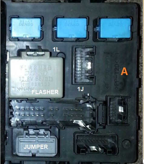

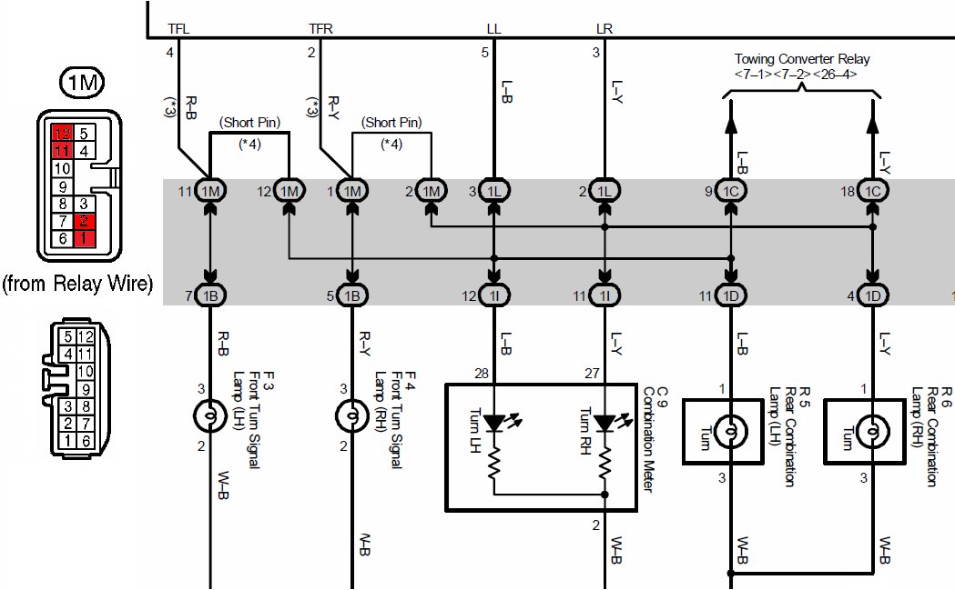

    You amateurs:rofl:, the vehicle is missing the jumper block in order for the "new" flasher to send power to the front turn signals.

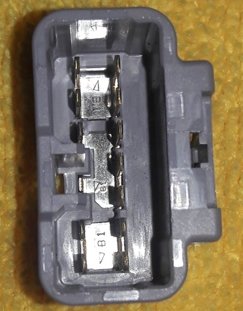

    Jumpers, but they would require a connector to hold them in place.
    1M - 90980 - 10802
    Terminals on the jumpers are 090 - 2.3II type.
    https://www.corsa-technic.com/item.php?item_id=1064

    Instead of buying the OEM jumper block 82671-30360 (was on backorder) I removed the original Y-harness on the back of the fuse panel, de-pinned the 12 pin connector and made two jumpers from terminals 1-2 & 11-12. Perfect! my front turn signals work and no hyperflash!
