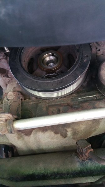

    I went out and looked around a bit more, and I do not see any oil anywhere around the power steering pump, so I guess it's likely not the timing chain cover. However I do see some oil below the crank pulley.

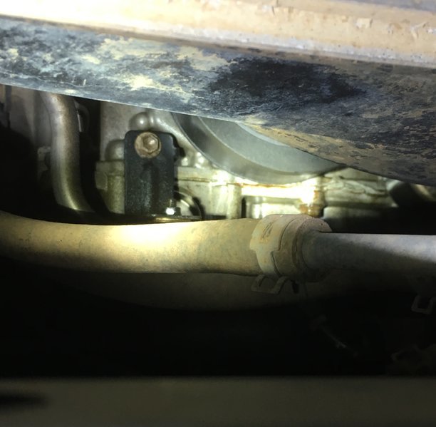

    This is what mine looked like. Never any oil drops on the ground because it's a small amount and usually occurs more when driving. Plus your skid plate is there.

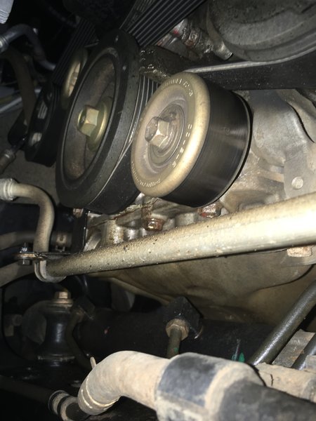

    I removed the skid plate this morning and looked a bit closer. I think I have a crankshaft seal leak AND a slight water pump leak. I went ahead and ordered the parts from RockAuto and will get a local mechanic to replace them next week.
    I didn't notice the timing chain cover leaking, but even if it is, it may have to stay that way.

    This might be going on behind your wp pulley.............mine was making a stalagmite. Nothing visible, wet or hitting ground but always losing a bit from the overflow tank level.
    If I were you I would get the oem wp. Every other one I saw comes with stupid paper gasket. I went back and got oem that comes with nice rubberized metal gasket. Wanted the new one to make 150k miles like the original did without having to mess with it again. Worth a few bucks more to me...........
