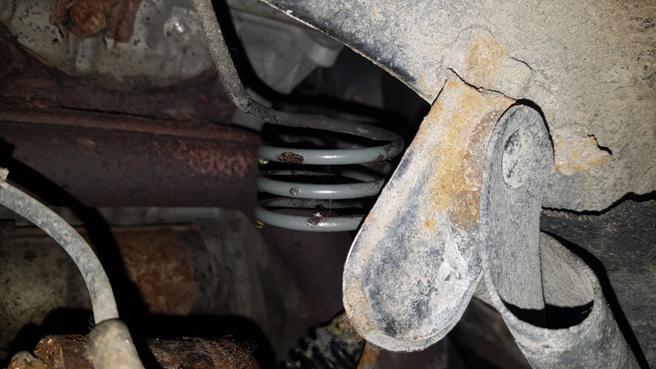

    Hi ! I wonder if possible to repair a hard line ? I have a small hole in the coil like section of hardline front driver side . My idea is to cut that section and put on a 8 in premade brake line . Obviously flaring both side with fitting before that. Does this affects anything at all? I mean is there a purpose for this coil like section ?
    Why not change the full line you would say .. well that crap is rusted af and will end changing all parts from abs module to caliper ..
    In fact that was my first idea but if i can repair would be better.
    So good idea or not?
    08 tacoma

    You talking about the pigtail looking thing at the frame?

    Yes that piggy

    I'd get a replacement for sure. The coil is there so that it can absorb the movement from the body (which the booster is mounted to) to the frame (where the brake lines hard mount to).

    Ok I go OEM, heres the part im ordering:
    • 4731804110 no8 brake tube
    • 4731604140 no6 brake tube
    • 9041210247 way union
    • 4731504160 no5 ''main piggy tube''
    do you guys think I should have the flex tube to?
    and any recommendation on the way to do it?
    like disconnect from abs module first? then the one that go to the flex?
    I read a post here that say drain the MC before dont know if its good or not

    So here's a little update on the job. Parts was ordered at toyotapartsdirect.ca , good price for oem parts ( fellow canadians only) and shipped quickly. Received today and it took me 3 hours to get it done.
    The hardest part was to figure out how to put the main one were it go without twisting or bending it.
    Good decision to have more parts ordered than just the one leaking. Rust never cure.
    After bleeding all four wheels with the wife, who pump and hold great by the way, I tested it on the road and have the abs do is things on sand.
    Everything seams up and running.
    The pedal feels normal and the truck brake straight and easy.
    I wanted to special thank's EME for the tips about putting a stick too depress brake pedal, very useful.
    And thanks to everyone who replied and helped me through this process.
    Like everybody says the best way to do it is to change with oem parts and avoid repairs on brake hard line.
