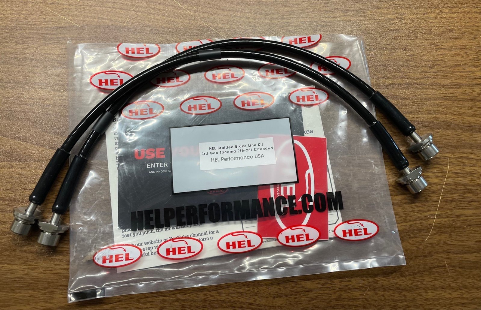

    Hey I sell HEL Performance lines (I am the seller @abou824 mentioned). We carry a full array of colors and lengths for the Tacoma. These are performance lines and are made to outlast your truck. Happy to get you setup with a set.
    https://store.classicminidiy.com/co...cts/3rd-gen-tacoma16-23-stainless-brake-lines

    I appreciate the offer but the brake kit actually came with stainless lines for the front that are approximately the same length as the lines you sold me. I did use the rear lines and was able to sell the fronts to another user to defray some of the cost. Thanks again, good doing business with you.
