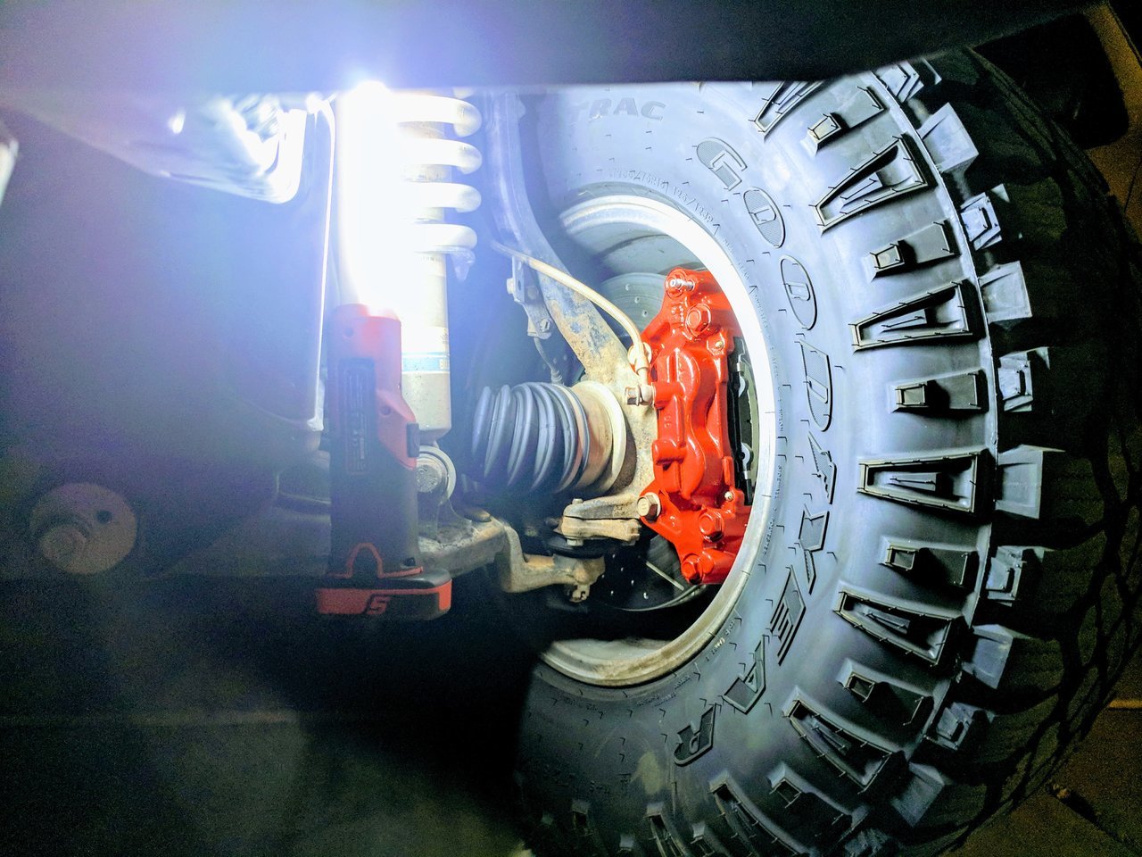

    10,367
    John
    Denver
    97 reg cab, v6 5sp 300hp supercharged, Methonal Injection, 800,001 plus miles, Original Owner

    01 4x4 Ext. Cab Impulse Red
    definitely looking into the tundra brake upgrade here as well, but I am concerned about my 16" 2017 tacoma trd wheels clearing the calipers
  10. Nov 30, 2017 at 10:12 AM
    #30
    boostedka
    boostedka Well-Known Member
    Sep 29, 2011
    #64367
    5,986
    James
    NM
    2013 DCSB 6MT, 2004 4runner
    Is that the kit that was linked earlier from Amazon?
  11. Nov 30, 2017 at 10:17 AM
    #31
    devinzz1
    devinzz1 Well-Known Member
    Jun 28, 2014
    #132892
    6,956
    devin
    lewisporte Newfoundland
    2023 aclb trd or mt
    icon stage 10 kit, toytec 1" bl, 35" general x3s, 17x9.5 procomp wheels, locker anytime mod, s&b intake, blackhawk 2.1 tune,
    youl need 1.25" wheel spacers from others experiences.
  12. Nov 30, 2017 at 10:20 AM
    #32
    BartMaster1234
    Aug 21, 2016
    #195197
    45,848
    Tyler
    Pittsburgh, Pennsylvania
    Flux Capacitor
    No shit really? I have the 2016 off road wheels on my truck and I tried running wheel spacers but it just made the frame rubbing worse. Was hoping I could run these without wheel spacers.

    i dont see how its possible spacers made rubbing on the frame worse. actually its impossible. rubbing on the body yes
  16. Nov 30, 2017 at 10:34 AM
    #36
    BartMaster1234
    Aug 21, 2016
    #195197
    45,848
    Tyler
    Flux Capacitor
    Let me rephrase: as of right now my wheels rub on the UCA at absolute full steering lock and nothing else. With the 1.25 spacer it started rubbing on the mudflaps and a little of the frame. With the 1.5 spacer is started rubbing the NUMMI sticker off the frame and making a terrible grinding noise.
    Long story short, no wheel spacers have the least rubbing for me.

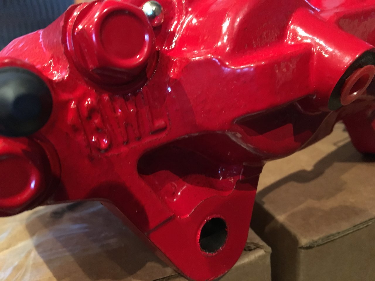

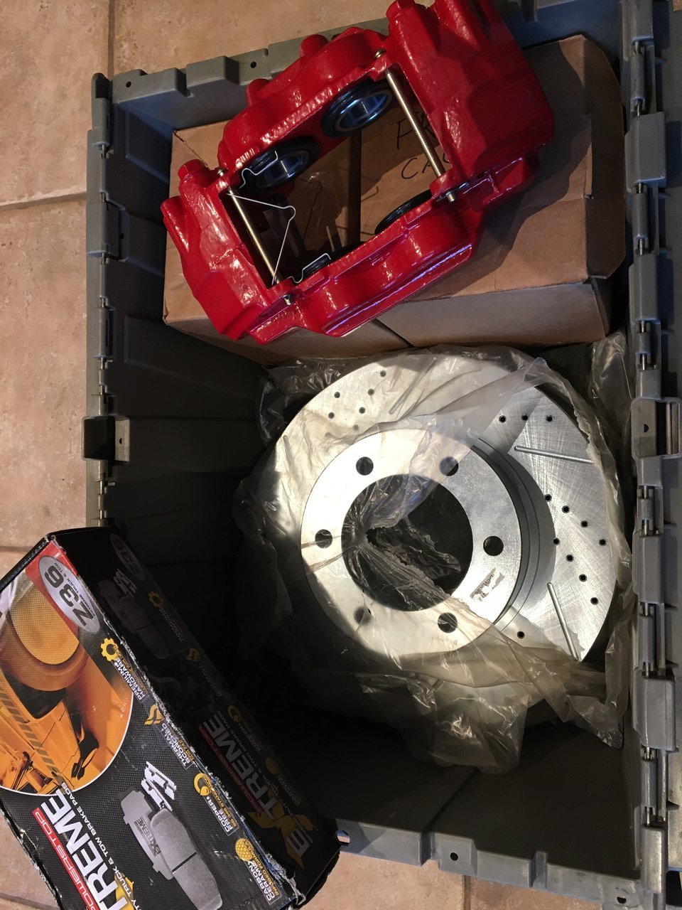

    About to pull the trigger on this brake kit. How was installation and how has your experience been since installing? Summit website doesn't say anything about these brakes fitting a tacoma so I am curious
  19. Jan 31, 2018 at 8:32 PM
    #39
    BartMaster1234
    Aug 21, 2016
    #195197
    45,848
    Tyler
    Flux Capacitor
    13WL right? Installation is very simple. You just need to cut, hammer, and bend the dust shield until it doesn't rub the caliper and clears the rotor.
    If you plan on using your stock brake line you will have to drill the banjo bolt, but I recommend just using aftermarket brake lines.
