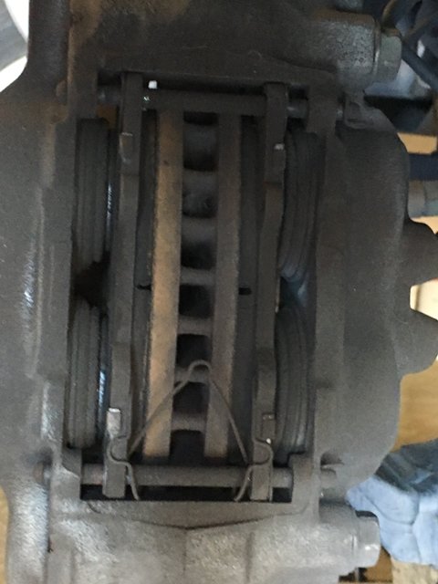

    I recently bought a 2015 Tacoma 4x4 TRD Off Road with 37k miles on it. I can't speak to what the former owner did with the truck, but I can state it had some braking issues, which I noticed after living with it for a week or two. The front rotors had a fair amount of pulsation while braking, which became more evident after I removed the BFG M/T KM2's and replaced them with BFG A/T KO2's. I attempted to bed the pads in again by going through 6-7 60 to 10 MPH stops, to the point I had a good amount of smoke coming off the stock pads with some pad material transferring to the rotors. After a long drive to let them cool, the pulsation continued without much, if any change. This made me feel like it wasn't pad material on the rotors and instead runout.
    I installed new StopTech cryogenically treated rotors with TRD performance pads this past weekend. While I have not tested braking performance due to breaking in the pads, the initial bite is reduced on my TRD Off Road (which is a good thing cause the stock pads were very grabby) and there is zero pulsation while braking. My 2001 Tundra 4x4 TRD warped the rotors in no time, until Toyota released a TSB to upgrade the size of the brakes, which helped a lot. I didn't abuse the brakes on that truck either. Runout does happen, it just depends on the vehicle, the type of driving, brake system components, towing, the driver, environmental conditions, etc. Rotors of lesser quality tend to show more runout or brake pulsation issues, than higher quality units from my personal experience.
