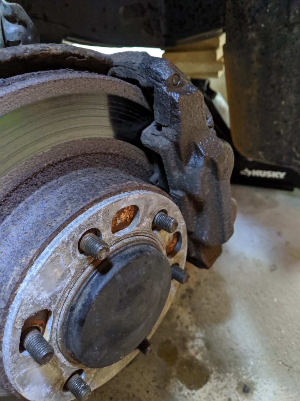

    is this what you'd expect from a 10 year old truck with original brakes at 117K miles?

    For being in Massachusetts, Yes.
    How’s the frame looking?

    good effing lord, remind me NEVER to buy a truck in a salty area. That looks HORRIBLE.
    1. brake caliper leaking fluid
    2. brake pad contact is MINIMAL, it should extend the full surface (or just about) of the rotor

    @TnShooter - Frame replaced this year... 4 months for them to do (sea of tacomas, frames stacked high, one technician, 3.5 days per truck). Looks nice! No body rust, so looking to keep the truck.

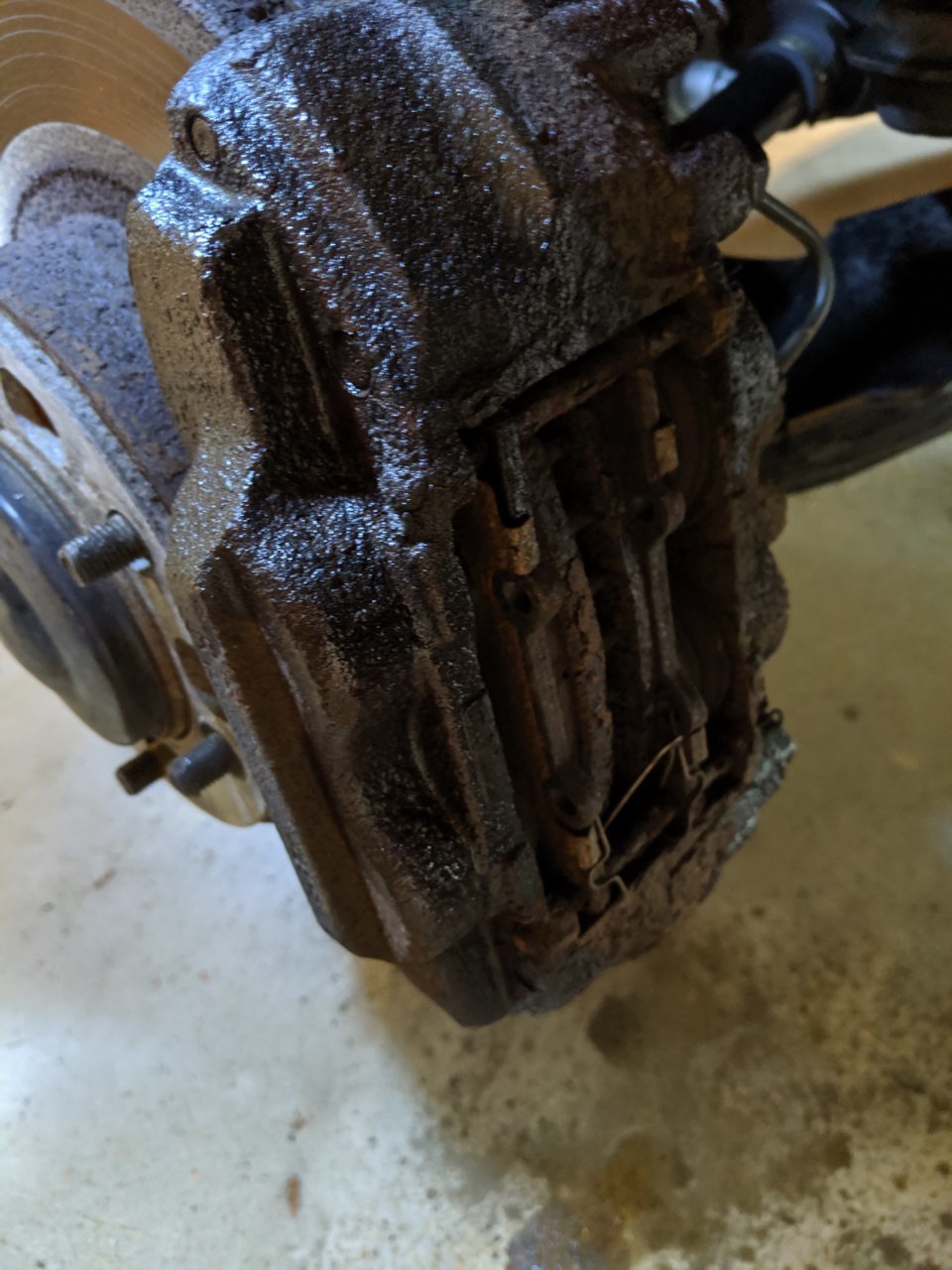

    @nd4spdbh - PB Blaster, not brake fluid for caliper replacement. They are stock calipers, so not sure about the contact area. Could be why I want better brakes?

    are those the new calipers in the picture?
    Also looks like your pads arent even touching the outer 1/4+in of rotor... thats ALOT of surface area not to be using.

    Brakes are shot, caliper is possibly frozen and brake fluid is leaking. For original brakes on a 10 year old truck with that mileage in a salt prone area though, you did pretty well. Time for a brake job though!

    Yup....replace rotors and calipers. Those pads aren't biting properly.
    Background stuff looks decent.

    No - its not brake fluid, but PB Blaster so I can pull the caliper bolts. Yes, the caliper piston has been "sticky" for a while. Toyota service technician says it is common for the left side to have this issue. Must be a manufacturing issue.
    Plus, the salt water and air is not kind. Major rust happened when I was parking the truck by Plymouth bay over a two year period. Luckily, Toyota replaced the frame and the body panels survived.
