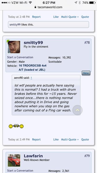

    How a 5 minute car wash can cause two pieces of metal to "normally" stick together preventing the truck from moving forward is beyond me, but I'll let the experts continue to say "I've seen it happen elsewhere, it's normal." I know damn well that if a car wash disabled my truck, id be on the phone with the dealer and opening a case with Toyota.
    And no, I've had my diff replaced once already and it still howls, in fact if you look at the videos in the howling differential thread, there is a good chance I filmed it.
