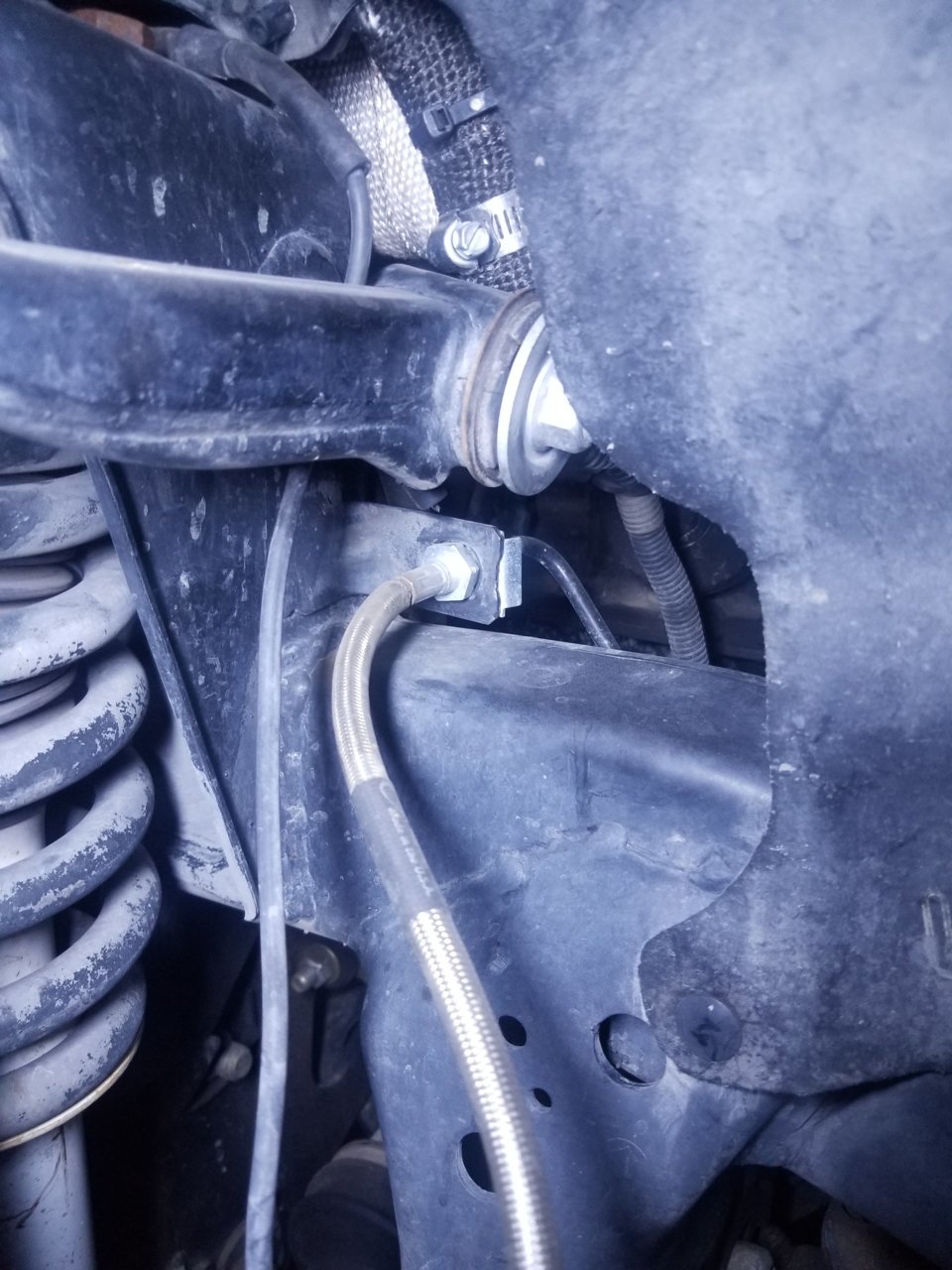

    That’s not a good time. I don’t see how to undo the rubber line from brake line. It seems to be crimped. I’m going to purge it in through the bleed fitting. Better than nothing

    The rubber to hard line should be cramped. The connection is by the frame.

    Ok, I see it now. I took the bleeder valve out and purged with air (rubber tip on air nozzle for snug fit) it made it into the reservoir (bubbles like a bong hit) and now my pistons have extended onto my pads where they aren’t loose anymore like they were. Which I’m sure is just air but still

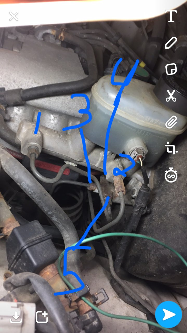

    Next, undo the 10mm hardline going into the farthest fitting on your MC/firewall. That should be the line feeding your front caliper. Use a towel to absorb any leak. Have someone slightly depress the pedal while another person is watching for fluid to squirt out.
