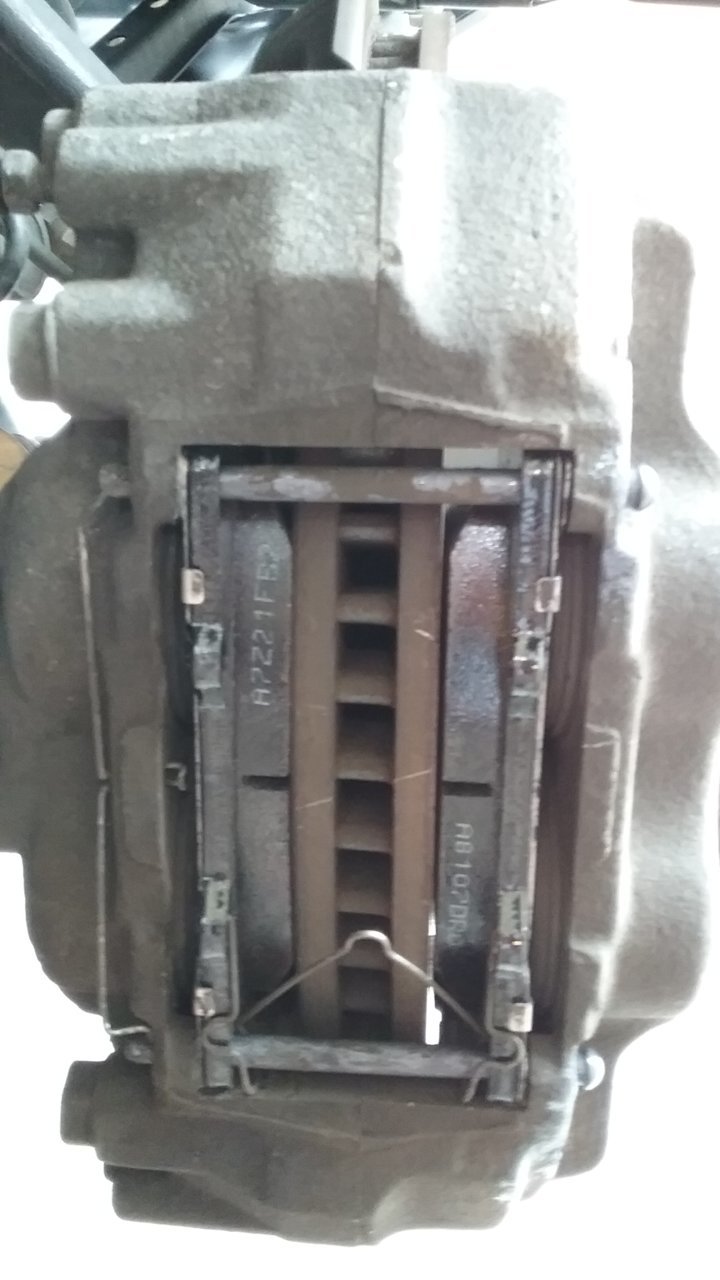

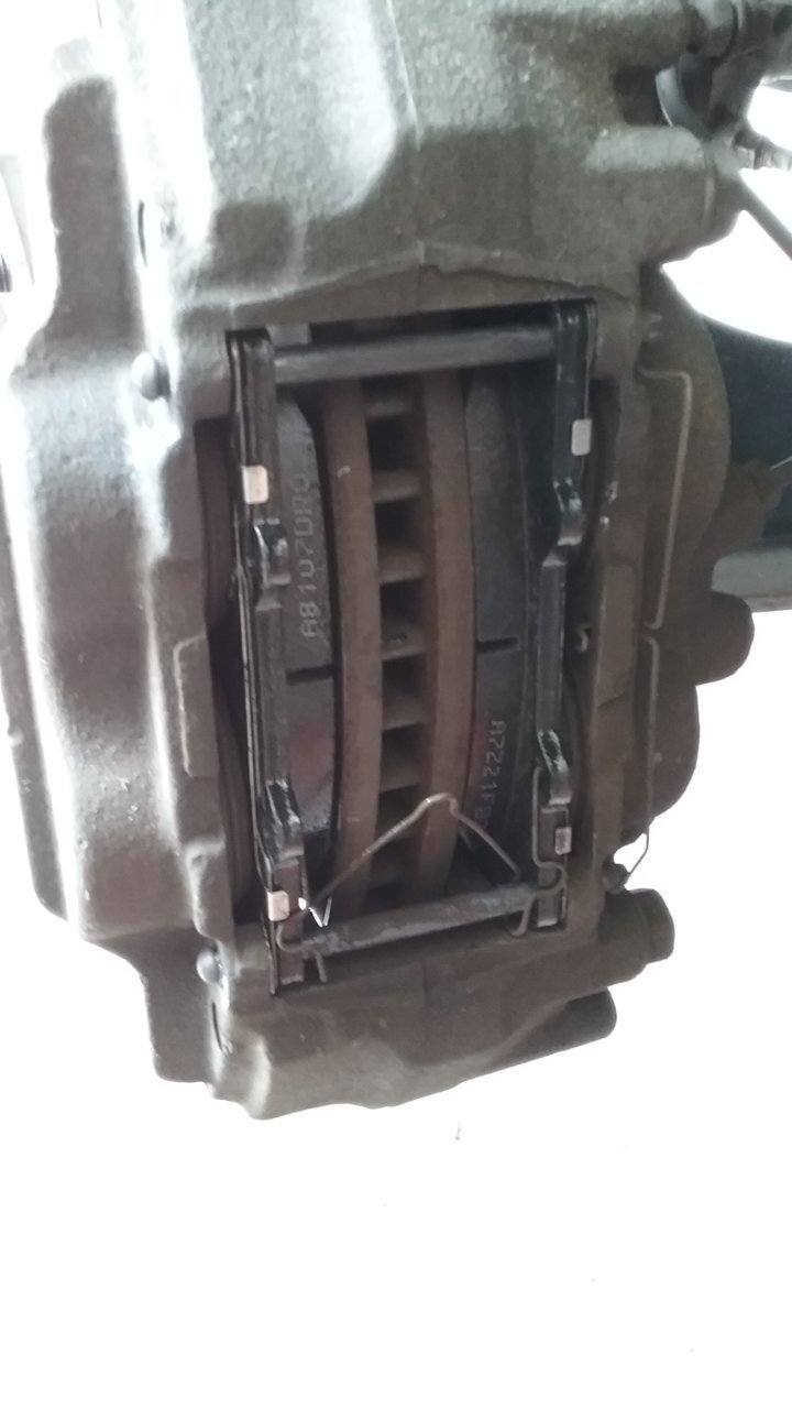

    Just did front brakes on my rig yesterday. Zero issues
    20200201_101658.jpg 20200201_095945.jpg 20200201_091605.jpg 20200201_091627.jpg

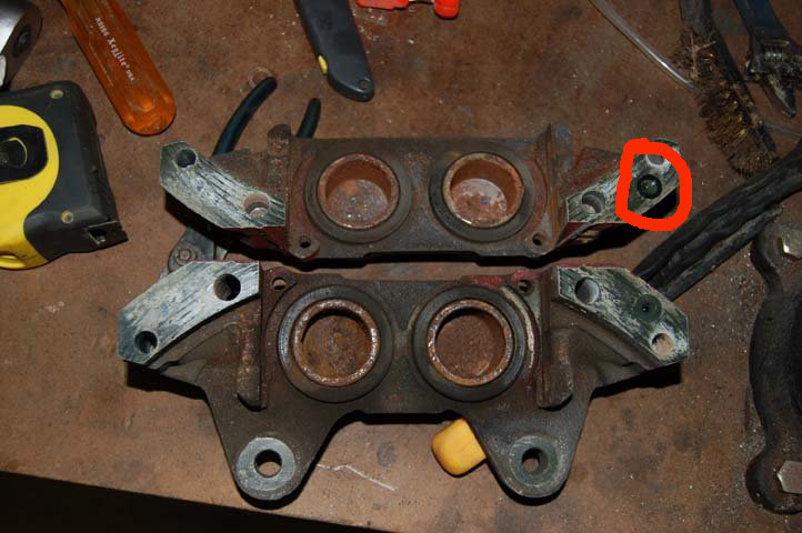

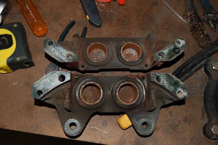

    I think the calipers have a bolt that can be taken out and split the two halves

    Did you put this O ring back in place? Ideally, it should have been replaced, but you might be leak free if it's in place.
