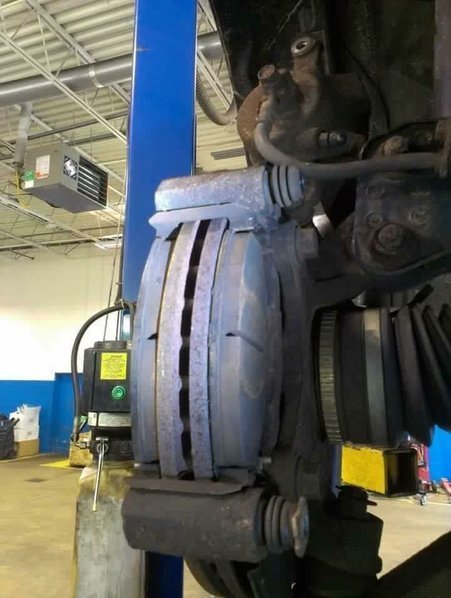

    Did you do this?

    Here is a video how easy it should be to change pads for next time. Its a really simple job unless the calipers are rusted where the pads slide in. Then you just need to file the rust off so the pads have room to slide in and out on the pins.
    https://www.youtube.com/watch?v=C6mB_YQP0r8
