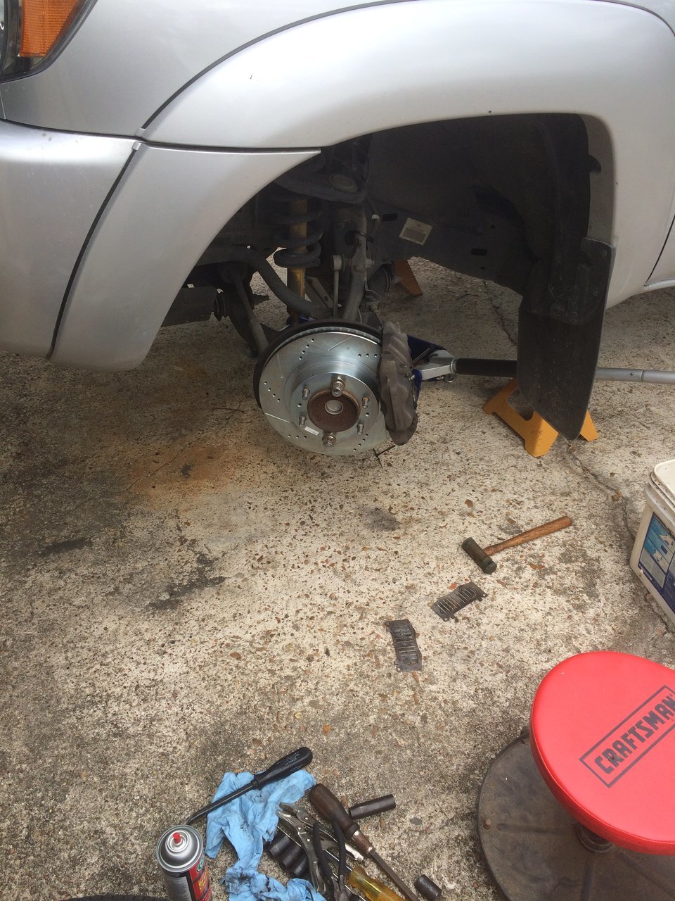

    I have some front brakes coming

    ever since I done the brakes its weird I can hear a noise driving down the road its not a grinding noise but like the holes in the rotors are make a noise. any one hear of them making a noise after they changed them

    You need to seat them, most manufacturers have a process for this.

    Yeah they came with a break in saying go this fast and stop this way. I did all that but you can still hear a noise. It’s just like road noise from tires but I had the tires before the brakes and they didn’t make noise so I know it’s not the tires

    could be somebody drilled straight through the internal vanes of the rotor so now it whistles. Does it change with speed?

    Speed doesn’t change the sound But I’m not sure where the sound is coming from. It sounds like you have a bad transmission but it shifts good and I have never seen anything from like a leaking transmission

    hmm... it seems like it may go away with time, but the brakes are probably fine if you havent noticed any other odd symptoms in the pedal

    no problems just noise. I took a friend for a ride the other day and he said he thinks its just tire noise. I rotate my tires every 5,000 miles and its about that time so I have them check the tires when I go in.

    I was driving and when I turn the wheel to the right the noise stops. When I’m going straight or to the right you can hear the noise. I think it’s the front drivers wheel bearing. I’m taking it to the Toyota dealer Monday
