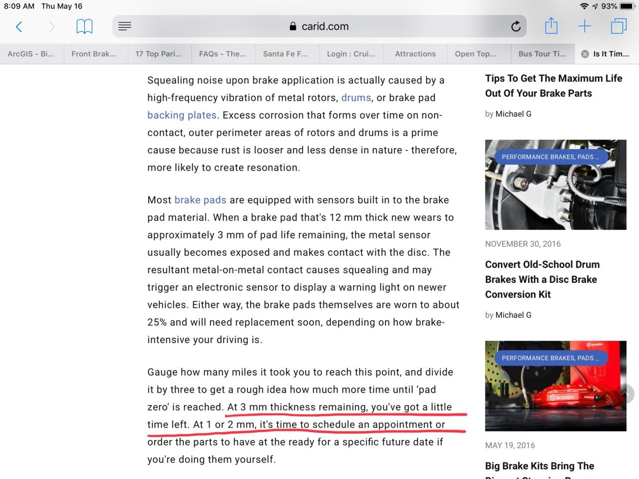

    Had a 55000 mile service (58000) actual miles, and dealers told me my front brakes were at 2mm. I put it off for now how long can I go , just around town driven ?
    Thanks Tom C.

    Do you know how little 2mm is? Its 0.078 of an inch. Your pads need to be replaced now, not tomorrow, not a week from now. If that 2mm disappears and starts hitting the rotor not only will you need new pads but youll also need new rotors.

    Thank You for the Reply, Just made appointment, Will go into dealer tomorrow am
