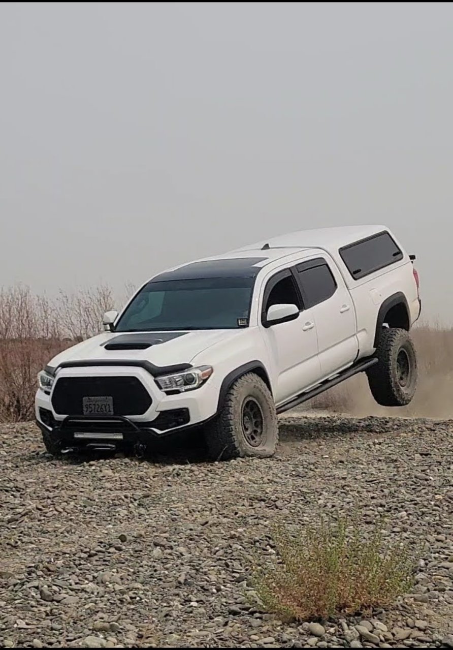

    I use wheelers in the front and have zero complaints Screenshot_20220429-044307_Photos.jpg
