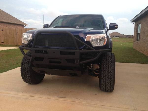

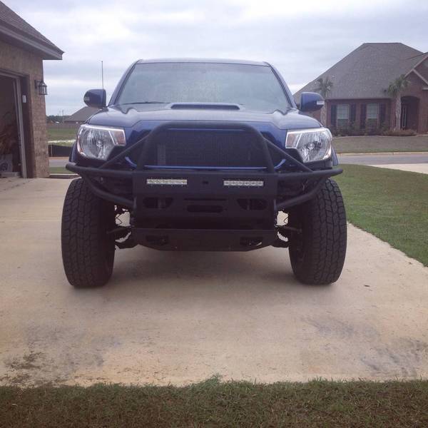

    I love my Bruteforce front hybrid. I would say all around even being a hybrid it will take more than the stock bumper. I haven't hit anything with the stock or hybrid so just my opinion and it hasn't been tested by my truck thank goodness. Oh but a trampoline def will dent your cab if it lands on it. :D All the factory bumper is is a piece of flimsy ass plastic and an aluminum bar behind it.
