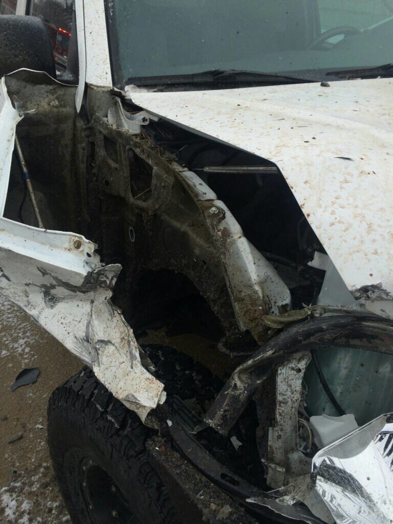

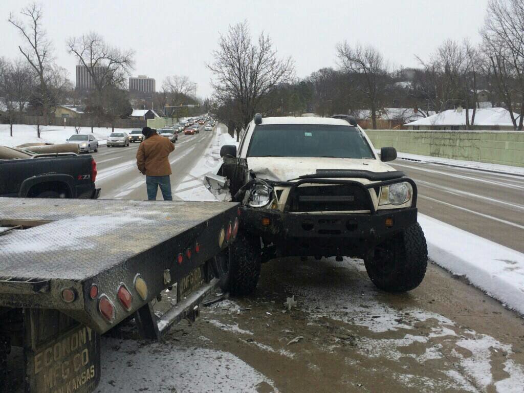

    Just a few
    Here is my truck after a collision with a dodge 3500. I was parked and he was going between 35 and 45.
    If it weren't for my Relentless front bumper my engine would have been smashed into the cab.

    Not to be picky, but I'm sure you meant under the cab. Engines don't go into the firewall. The design of the front end pushes them under the truck. It's been that way for a while now. When my brother totaled his early 2000's GM truck I went to see it and his 327 had left marks on the firewall right where the transmission is supposed to be :eek:. He walked away from it.

    Yes...into the firewall and down....not thru
