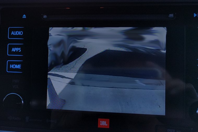

    After wheeling today I realized I can't see a damn thing in front of me when going uphill. Waiting for someone to try this... My ideal setup would be a front camera that I could view on the OEM nav screen with the flip of a switch.

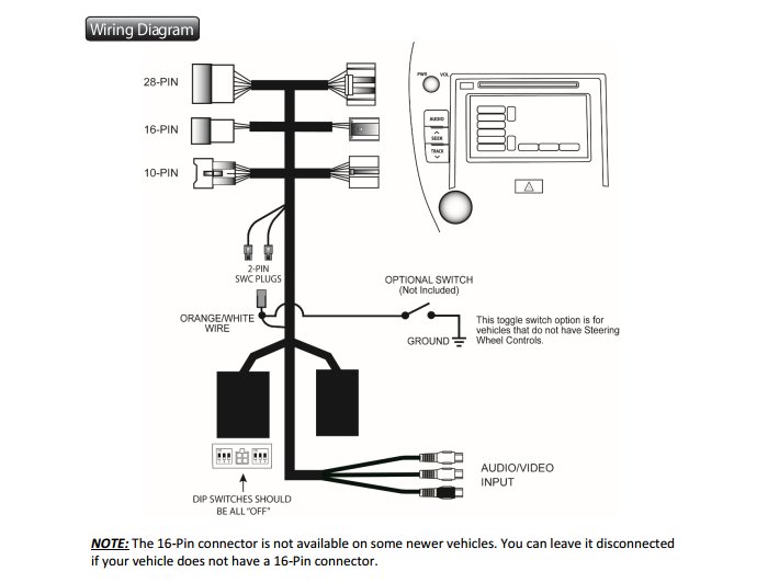

    I looked into the manual for the CRUX VIMTY and I think it would prove pretty simple to integrate a camera into the entune system:
    I would prefer to use a switch rather than the Steering Wheel controls; and I think this would be doable with this schematic. Alternatively you could always default to the steering wheel controls which would look slick as well.
    I'm thinking about pulling the trigger on this; with the Toyota emblem and this unit total price would be ~130 which isn't that bad - a separate switch would put it up to $150. Appreciate your thoughts.

    Project on hold until I receive my replacement. The VIMTY override works great but the A/V cable on the unit I received was damaged and would only display video when I squeezed the crimp. I'll be documenting progress in my build thread!
    @Skystrider17 I'm curious how you planned to wire it, I was going to use an Air on Board switch to trigger the camera but your post got me thinking about also using it to activate the VIMTY. The only thing is, outside of the camera the VIMTY has so many other great uses. The steering control method is very KISS.

    Odd behavior with the VIMTY today and I couldn't replicate it on demand. Yesterday I was excited because I thought the VIMTY "A/V" audio source was sharing the OEM "AUX" audio source. My particular config has me running the AUX port full time because I'm using an old SiriusXM lifetime subscription receiver. I was able to have "A/V" selected (the bumper camera) while listening to the "AUX" source.
    Today every time I turned the car on / off it would exhibit either the same behavior as yesterday OR not share at all. I didn't change anything else and tried all sorts of on / off combos today to see what triggered it. We'll see what the replacement unit does.
