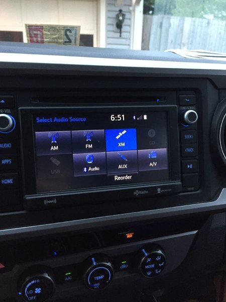

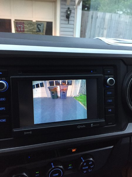

    Wanted to post an updated on my install; I used the VMITY harness and logo camera. I select the AV input under the "Audio" tab and this activates the camera - however it only works if the Parking Brake is on. Holding up on the left Steering wheel D Pad basically fakes the car into thinking the Parking Brake is on, and you can then use the camera while in drive. The only problem I haven't solved yet is that when going faster than 1-2 miles an hour the car emits an alarm - driving with parking brake on. Does anybody know how to disable this, or have a workaround?

    Not sure about the VMITY-01, but I just installed the AVITY-01 and don't have the parking brake issue. I would verify that you plugged in the 5 button SWC plug and not the 9 button SWC plug. The AVITY was shipped with the 9 button plug connected.

    hooked my up properly finally. turn on with an air on board switch which runs to a relay in my bussmann rtmr. installed an led light right next to the camera on the bottom of the license plate holder on the same circuit in parallel. haven't gotten the press and hold auto function to work but i don't mind. Not sure i hooked up to the right wires for the buttons but i don't care enough to pull everything off to figure it out. it works fine scrolling through the sources.
