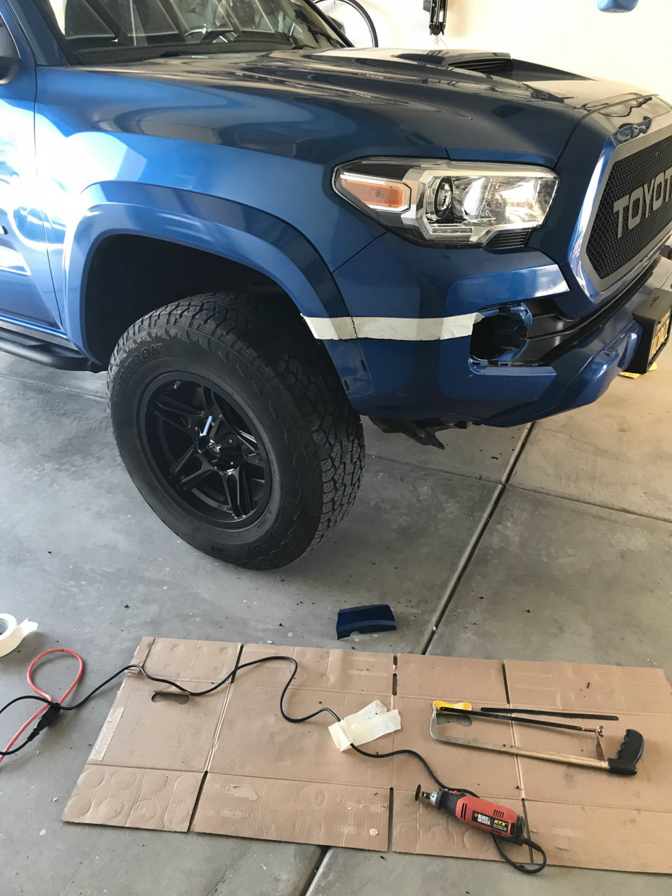

Front bumper cut measurements? Where do you cut?

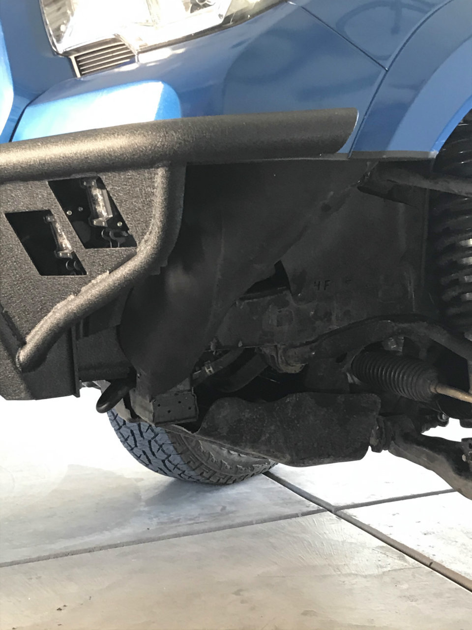

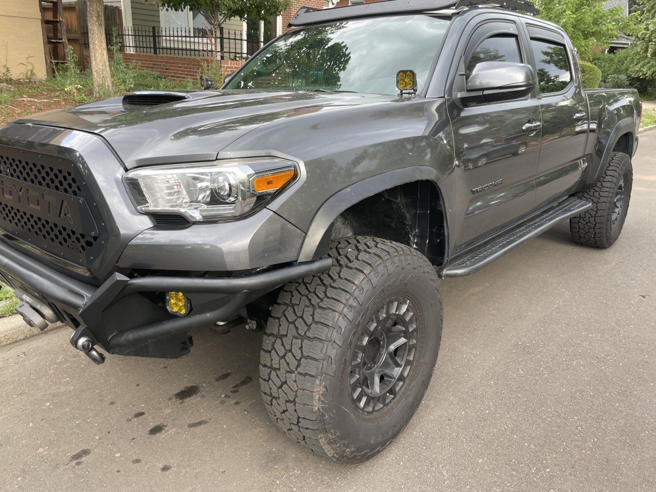

    When I made the first cut I left about a 1/2 inch extra, of the lower cover, on there. I pre fitted the bumper, removed it, and made my final cut. Also you can buy some black or other color edging to go over the cut line when you are done. Hope this helps you out.

    A picture with the edging on the cut line. Also I used some plastic, from a trash can, to clean up the fender liner.

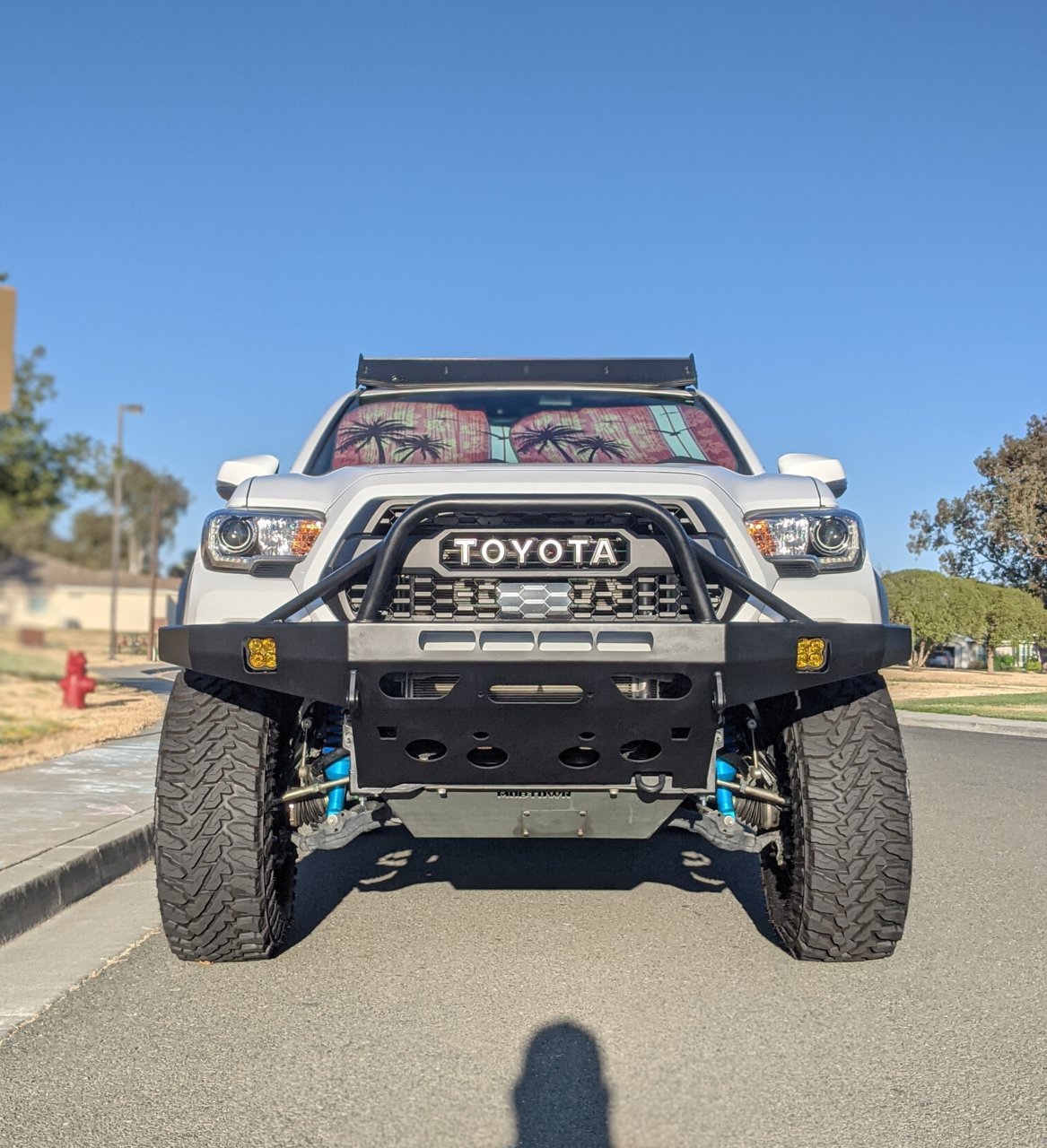

    It's finally on! :bananadance:

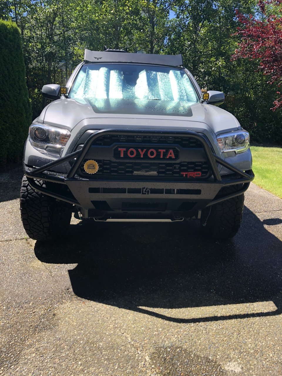

    C4 Fab. Hybrid front bumper. Would look better if I had gotten my light bar and universal mounts for fog lights.

    There’s a shelf on the bottom of the grill. I drilled 2 holes in it. Right above the oval holes in the cross brace. Zip ties. Make sure you don’t hit any wires.

    Looks nice! Where did you get this? I just see "Coming Soon" on their site for 2016+ front bumpers.

    I called the number on the website and got a hold of Billy. He's a good dude. We shot the shit on the phone for a bit and he even offered me some technical advice.
