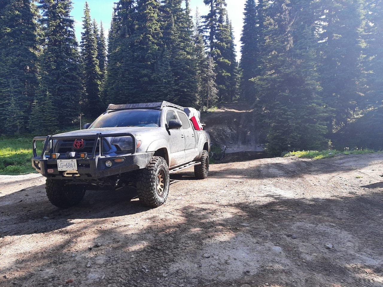

    I went with an aluminum bumper this time to keep weight down. If i need to push anything i have the heavy bull bar. Tow hook for pulling. I used to build steel bumpers but my mind set has changed to keeping the front weight at an absolute minimum. The bumper weighs maybe 10lbs it is LIGHT. There are a whole lot of bumper builders out there but they are usually pretty heavy to ridiculous. If your bush crashing stick with steel.
    This is the only shot i have.

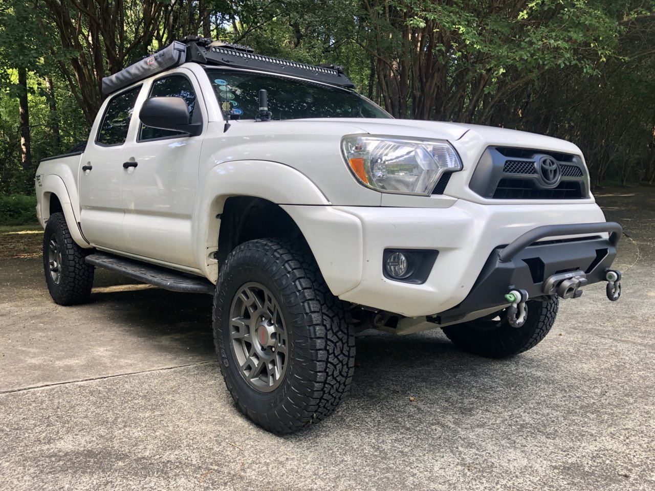

    I built my own and without lights or winch weighs 80 lbs, which is on par with aluminum bumpers. For a hybrid or full plate bumper you're looking around 115-140 for the most common ones.
    If you're wanting to save weight then I recommend a low profile bumper, such as SSO. Those weigh not much at all.
